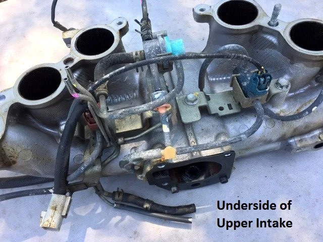

If the EGR was still there that would have been my go to as well. I’ve capped all the vac ports on the top of the TB related to EGR and evap. Is there anymore ports hidden underneath I missed? According to the vac diagrams and pictures I’ve seen on here all the junk that’s underneath is just dead weight if everything up top is capped off.
Feb 7, 2009
2,524
There is vacuum lines underneath that need to be taken care of they could be leaking and creating noise if came unplugged, what did you plug when you pulled the charcoal canister because it feeds in to the intake through a valve, there is vacuum line under the tps sensor that has to stay, and you need one to feed the fps on the fuel rail. Could be the seal on the booster at the check valve.

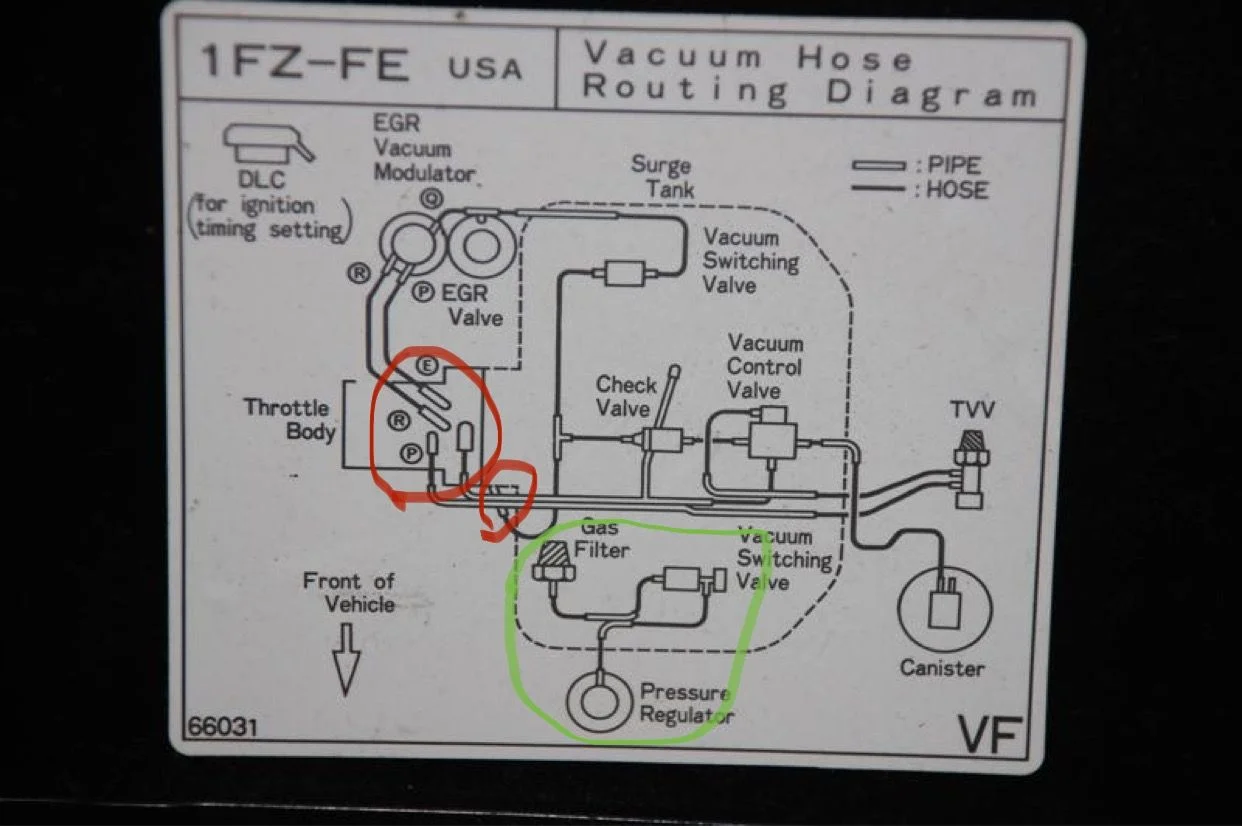

Nov 11, 2017
141
Nunya
pretty sure it’s not any of those lines. I’ve capped all circled in red. All that other crap is long gone.
The only stuff left is the FPR circled in green, and I’ve replaced the four vac hoses associated with it.
I just can’t remember if there was anything else under there I had capped at one point.
Thanks all for the suggestions. I’ll dig in a little more tomorrow. Just don’t feel like pulling the upper intake again. Especially in 90 degree heat.
