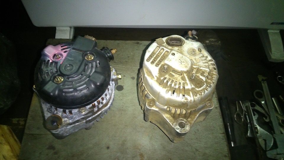

Train Tamers?!?!?!!?My Cruiser has a 1HDT. It was imported from Japan. I see that Train Tamers offer the their 27060-17250TT as a replacement, with output at 120A.
Can anyone recommend a replacement upgrade for that engine?
I just had mine rewired, and got the call a few minutes ago....160 amps!! You might want to go that route.My Cruiser has a 1HDT. It was imported from Japan. I see that Train Tamers offer the their 27060-17250TT as a replacement, with output at 120A.

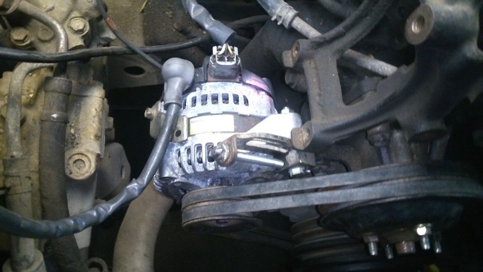

Check with Georg for details @orangefj45Ward,
Do these alternators require a different harness pigtail?
That's exactly what was done.
I'm also interested in anyone has experience installing in a 1HDT... Need some extra juice to charge my trailer batteries.
