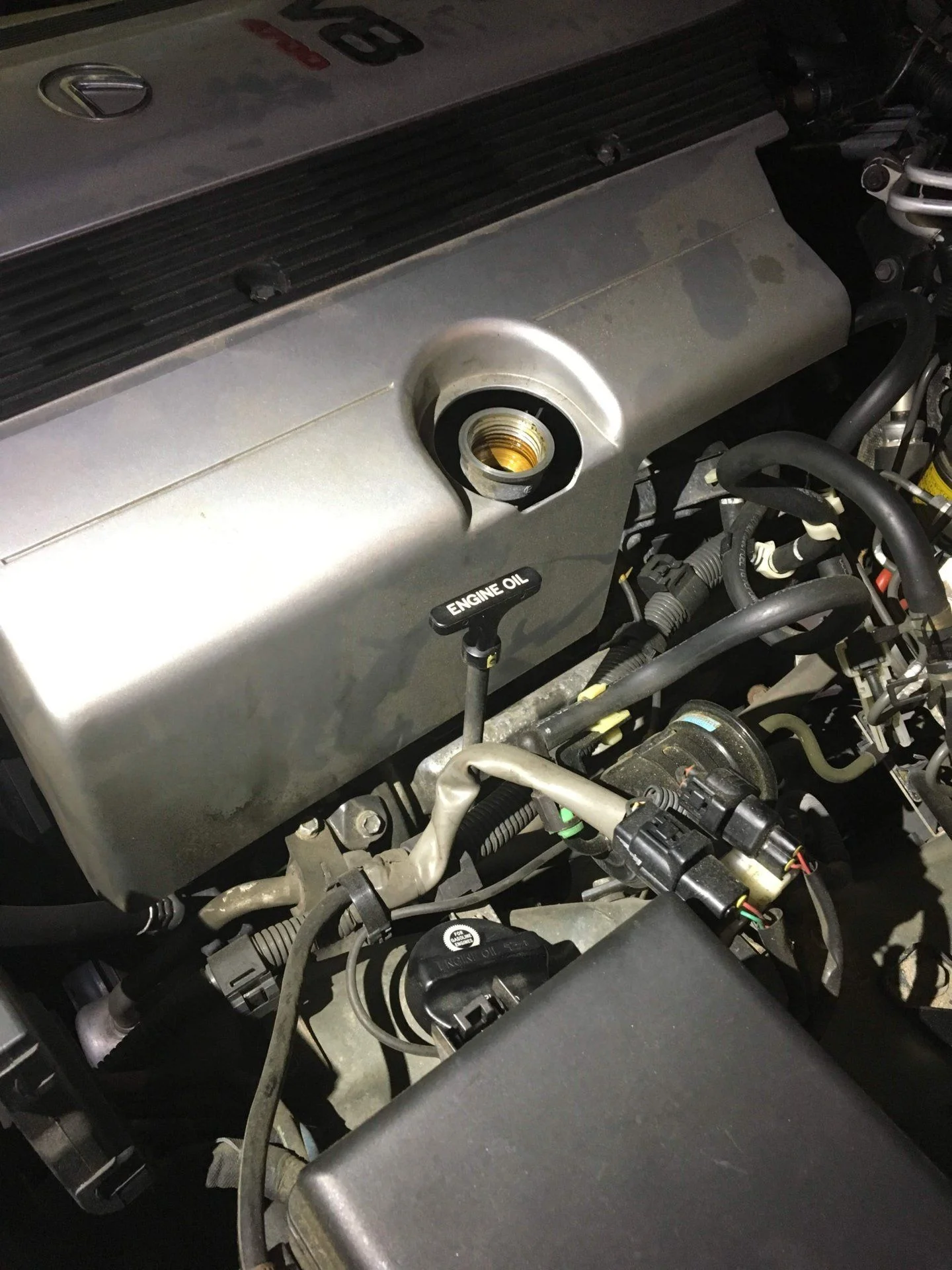

Did my first oil change this weekend and what came out was black non synthetic. Filled with M1 5w30 like i run in everything else I own with a M1 filter.
Drove a day or so and went to check it last night and found i left my oil filler cap off, oops. Thats a first time for me. I was pleasantly surprised oil didnt spew everywhere.

You'd be surprised at how little oil you'll loose leaving the fill cap off.
There is usually a splash guard inside the valve cover to prevent oil loss in just such an event.
