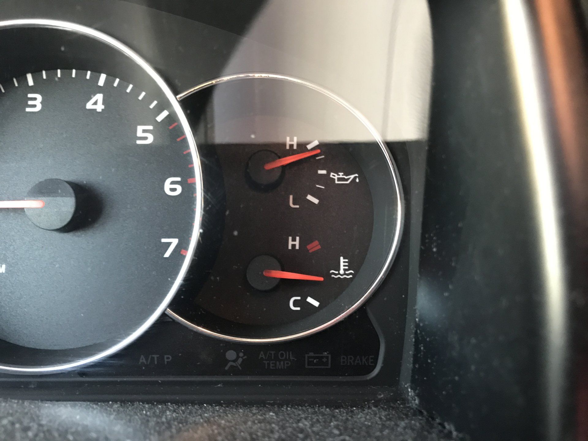

My oil pressure on a hot summers day, at the dunes after bouncing the tach off the rev limiter for a few hours climbing hills in sand so soft and deep you sink to your ankles when you try and walk.

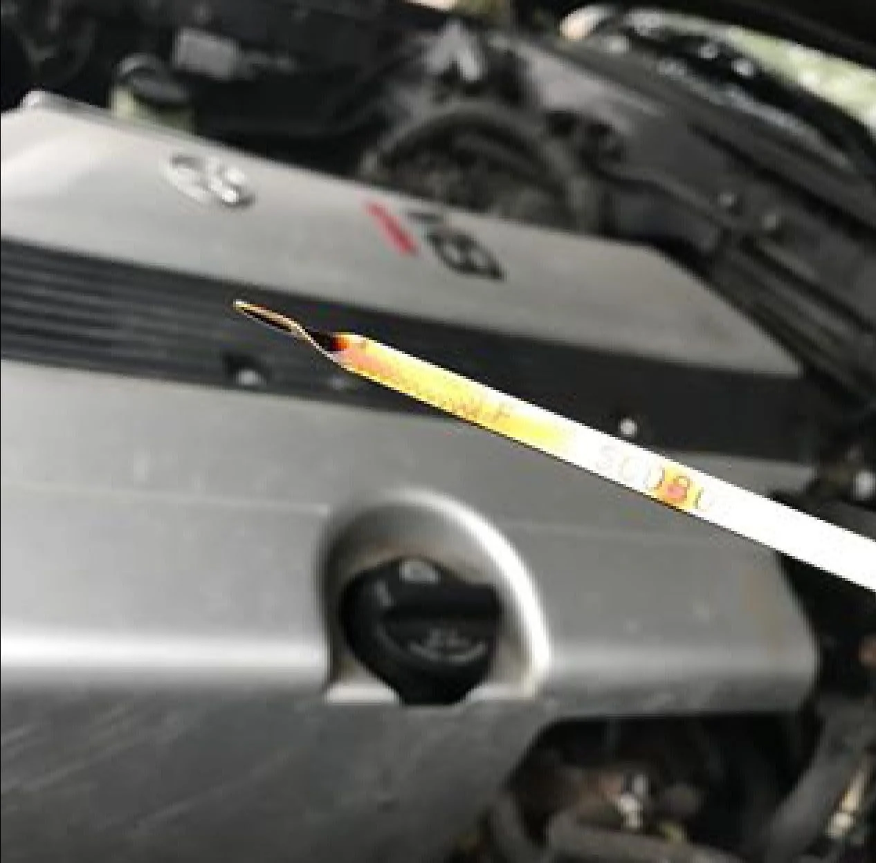

What my oil looks like after 5,000 miles.
