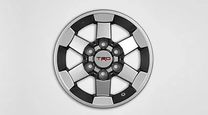

I have a 91 landcruiser. I want to put 16" trd 7.5 6 spoke wheels on it, with 33 1250. Is this possible without lifting vehicle ? I had stock all. rims on there. Will the 16 trd's fit my lug pattern ? do I need spacers ?
What is the back spacing of the trd wheels?
If it is 6 lug it should fit.
What is the center hole diameter?
tire size is not a problem, 33's will fit without lift.
Like this?
These fit but you won't be able to use the center caps on the front even with 1" spacers. I bought some for my 80 and test fit them but I plan to powder coat them before mounting so I don't have pics. Search around, a couple of guys are running them.
Yo Burgundy! The 33s will be fine from what I have read on MUD. You will have to buy new lug nuts to fit this type of wheel I believe. I've seen them on CL for as low as $85 for OEM. $65 for non OEM. Dealership $240ish. Not cool.
I think 12.5" is too wide to fit on a 7.5" rim, that could be a problem.
