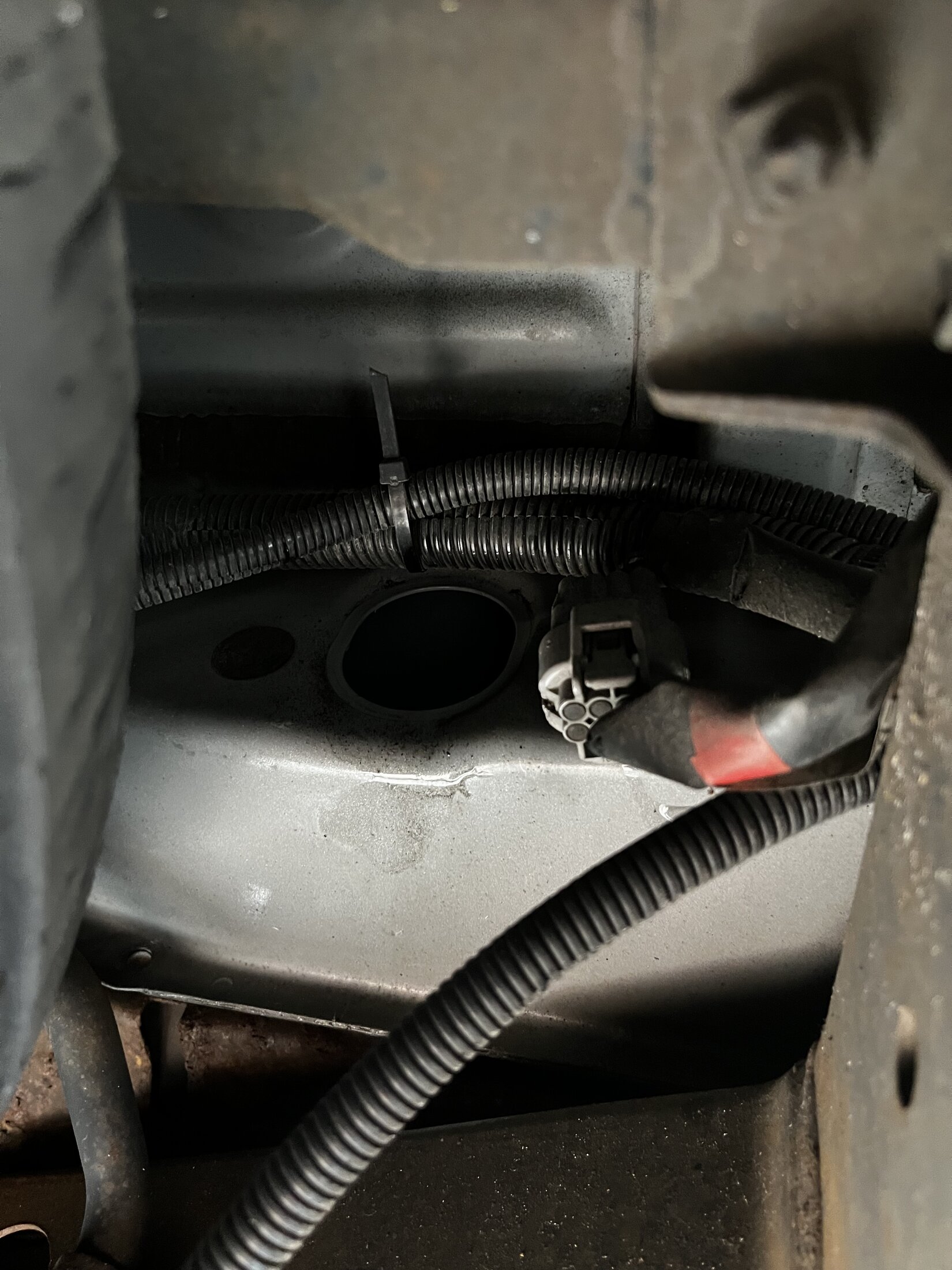

Alright, took another look today after overnight rain. Nothing wet on the interior in back. Water is getting into, but not out of, the body crossmember above the spare tire. I popped off the plastic plug (unfortunately, to the interior of the channel…have to figure out how to retrieve that now).
Still unclear on how water is getting in to this channel, or if there are supposed to be drains going out of it. I’m tempted to drill a couple small holes and prime surfaces to keep water from pooling in there, but would rather identify how things are entering in the first place!
