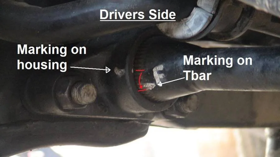

What's seized is the splined section of the TB into the bracket, not the bolts. Here's a picture from another post.
