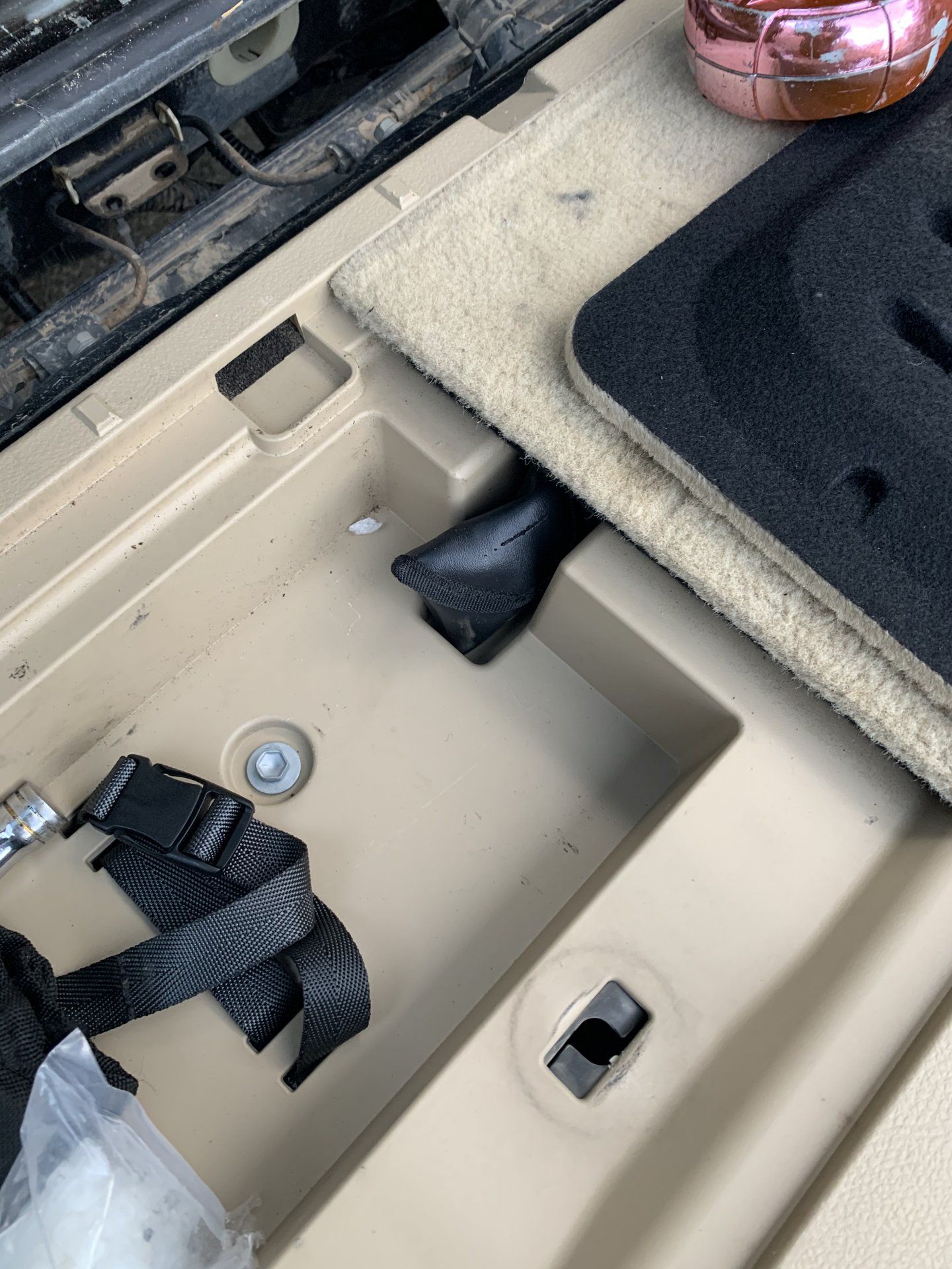

I know you bought one, but another place to look for the original is in or next to the toolkit in your tailgate. I had one in there. . .
Thank you. Yeh that’s where I looked initially and started to panic when I couldn’t find it. I also fhought it might be in o plastic Lexis bag in the Jack/first aid kit cubby bit nope. What I had read initially was I was supposed to have these preprinted cards with the rigt key code on it that I needed to use to reorder them.
Yeh I had looked in there as well and the jack cubby but nothin'.
