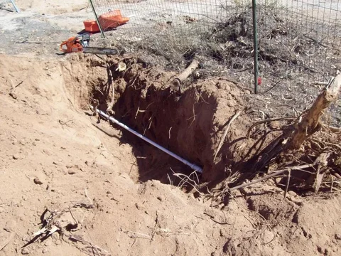

I just took out the main water line to the house today trying to get the tree stumps removed..:frown:

Water line repair after being torn up with roots when removing the stump. Good idea to keep an extra worn out bar and chain for cutting dirty wood.

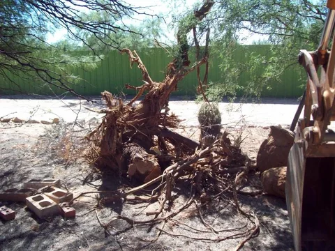

Here is one of the stumps, not suprised that the majority of the roots were going to the newest leach field.
