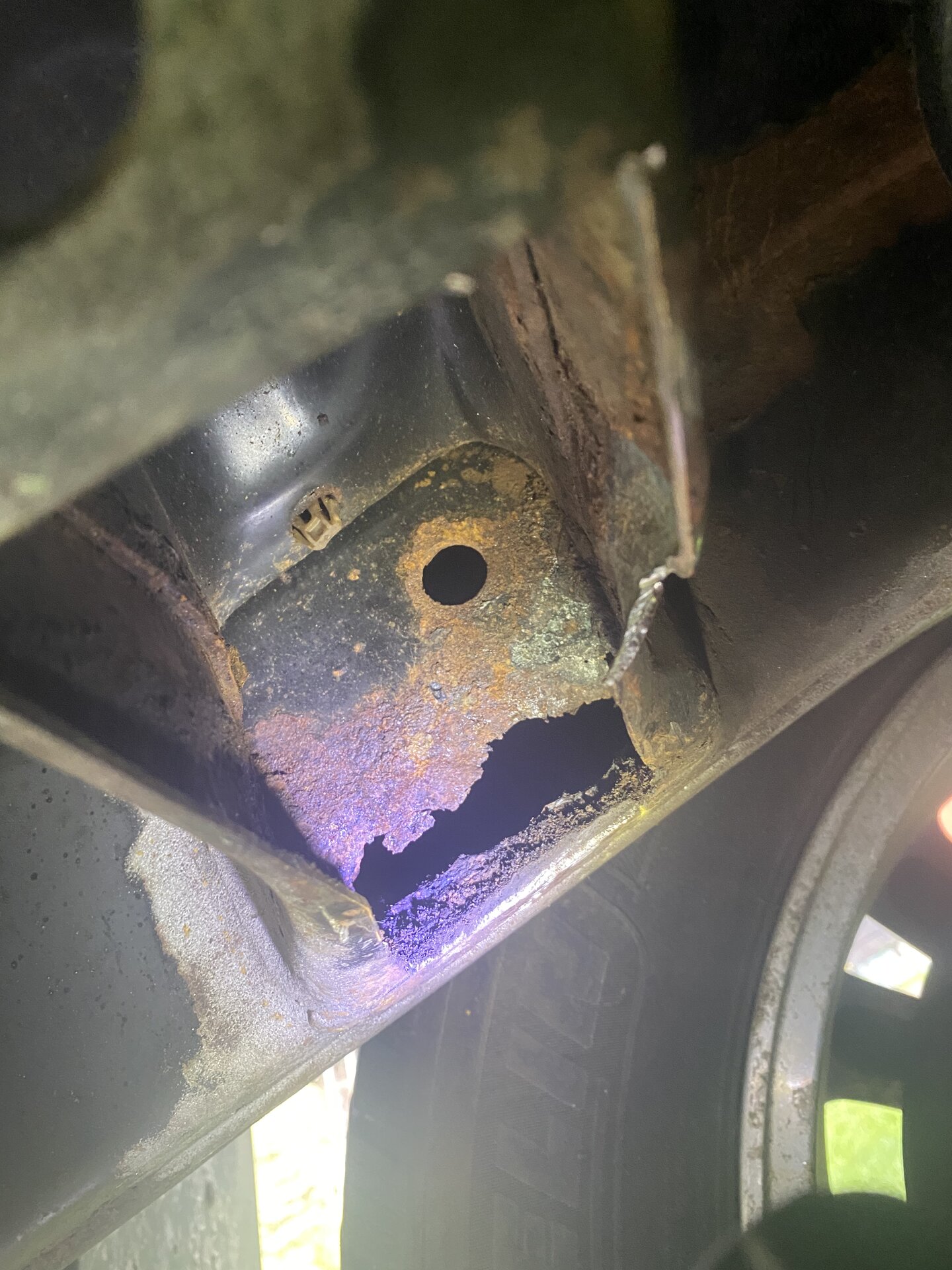

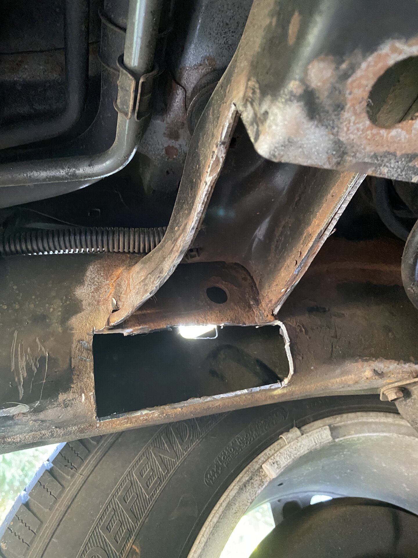

Need some advice on a hole that I found on my frame. Gotta love rust belt trucks :frown:
I took it to a local body shop who dug into it and ultimately decided against welding to repair it. Apparently the previous owner attempted past repairs with epoxy. The shop’s suggesting I find a new frame or portion of the frame to replace it.
Does this look like it would do it?
I’m lost on what can or can’t be fixed on frames, any advice?
Super common place to rust out, even on perfect examples. That’s easily repaired with a small steel patch, a welder or a buddy with a welder, grinder, and 6er of your preferred beverage. Couple hours tops, including beer breaks.

Thank you, this makes me feel a lot better!

you don't need a body shop to repair that area.
you need to go to a metal fabrication shop or welding shop to have it repaired

Harpersferry100, I have rust in the same area. I'm yet to address it, but as long as it hasn't rounded the bend, my plan is to weld sheet metal there. The eBay link in this thread is for a full rear frame section that I believe would need to be welded on too. (correct me if I'm wrong there, but a bolt-together frame seems strange). So its better to weld a small thing than a big thing.
P.S. my first thought when seeing the underside of your rig was "wow, that's shiny" so IMO your frame is in good shape. A little love and it'll be good as new!
