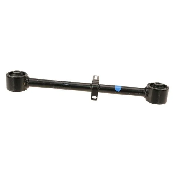

I have used search, went through 6 pages and tons of threads but I cannot find what I am looking for. What is the most economical way to address cracked and worn Rear control arm bushings? My uppers are cracked big time and I think this is the source of much of my "wandering" on road. Looked at Rockauto, and nothing there. Lexus OEM is over $200 each. What are you guys doing to bring these beasts back into some sort of decent on road manners? Pressing in new bushings? Or, is there a bolt on replacement assembly available? Thank you in advance!
I just bought my uppers from Partsouq like @JunkCrzr89 said. Was about ~250. New bushings can be had, but you dont end up saving much if any $$$/time vs. just buying new arms.
I bought new toyota bushings and pressed them in. I was trying to save money, because I am replacing all the bushings. If the lowers are 20 years old, so are tge other bushings. You might as well do both the upper and lower, as well as the pan hard.

1/2 :banana:. Not a ton of room to work near the coils, but enough. Keep the floor jack handy if you need to move the axle around to align the eyes. Took me about an hour with beer in hand.

Easy to do. Don’t need a Jack and don’t need to take the wheels off. A good ratchet strap is all one needs to maneuver the axle around and get the holes lined up. I replaced all 4 with the tires on the ground.

For those using this thread as a resource, I had a lot of trouble getting the bolt holes to line up with the bushing holes, and using ratchet straps didn't help enough. I wound up using a floor jack on the pinion of the rear diff in order to "rotate" it forward. Took me several hours to replace all four. I also used new hardware (nuts/bolts/washers); the old ones were somewhat corroded.
