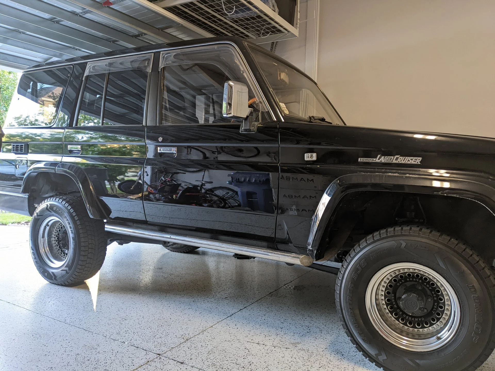

So, I've been trying to verify whether this newly imported 1995 KZJ78 is lifted or not, and what kind of setup is this..

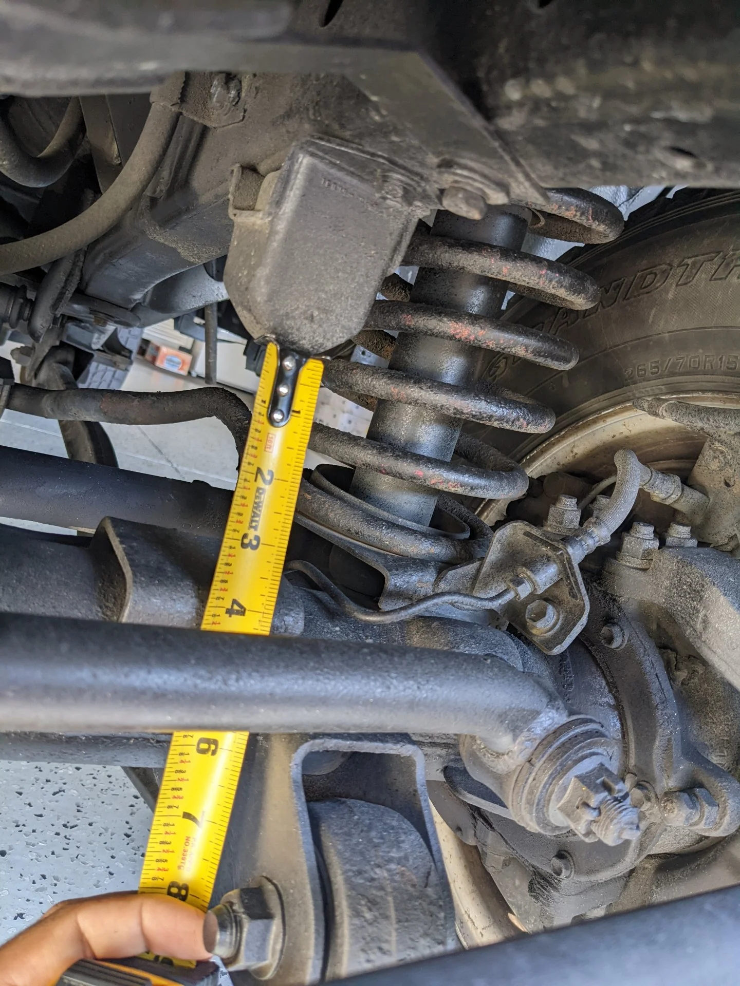

Judging by this measurement, I have 4" distance between the top of the front axle housing and the bump stop.

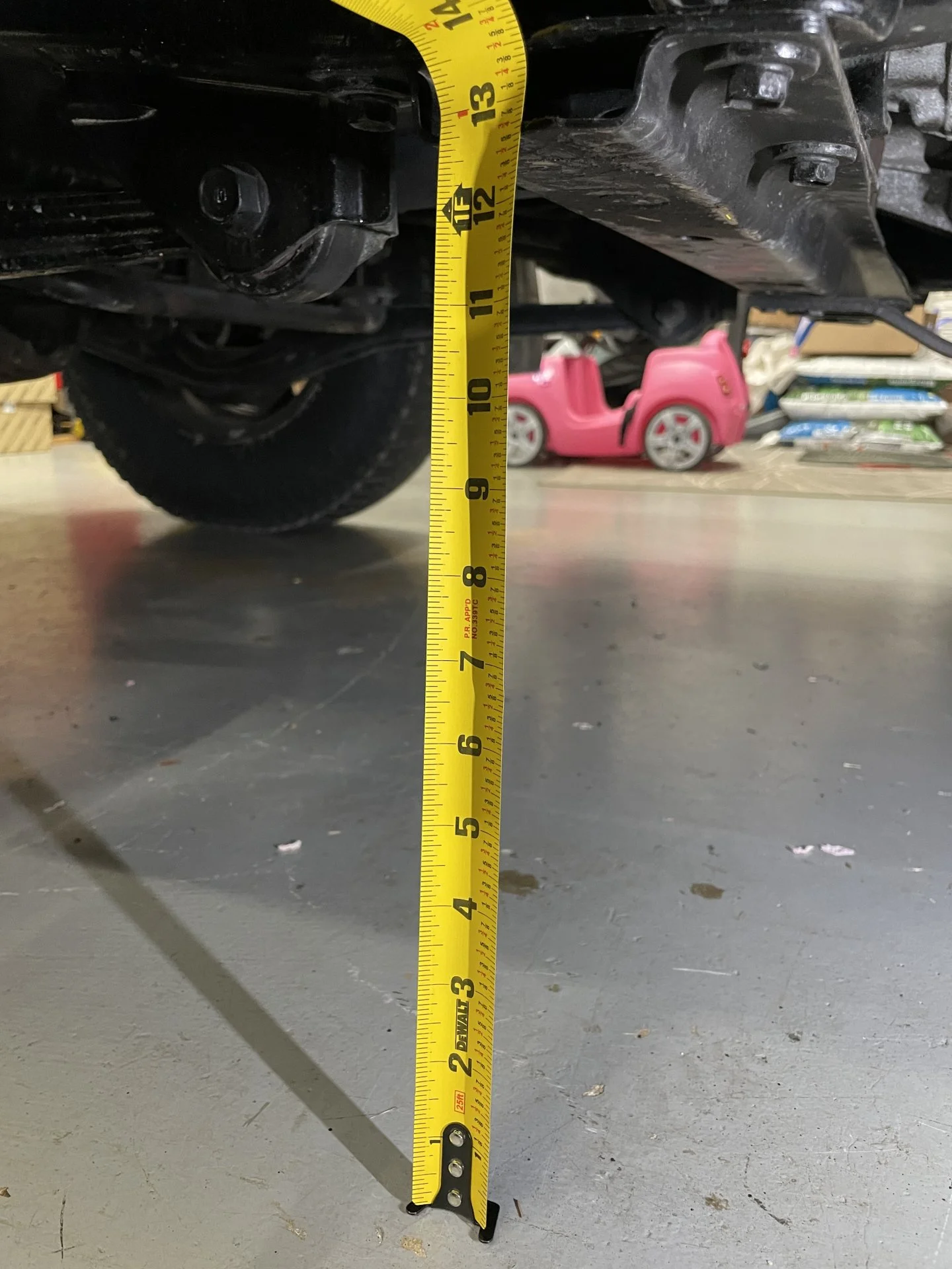

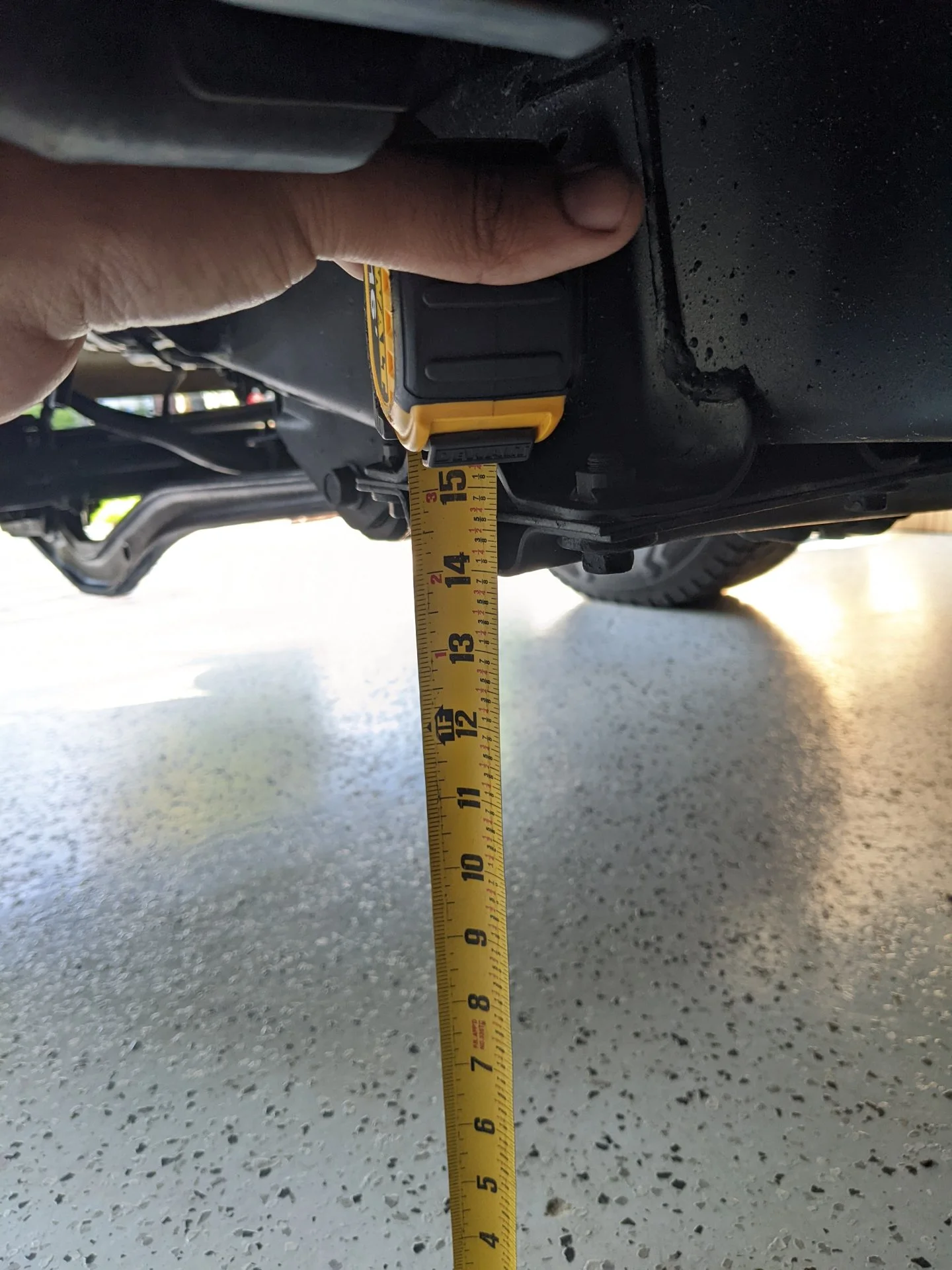

And here is a measurement from level floor to the middle cross member (that holds the transmission). I have 14". Now this rig is sitting on a set of 15" rims wrapped in 265 70 R15 (an almost 30" tall tire).

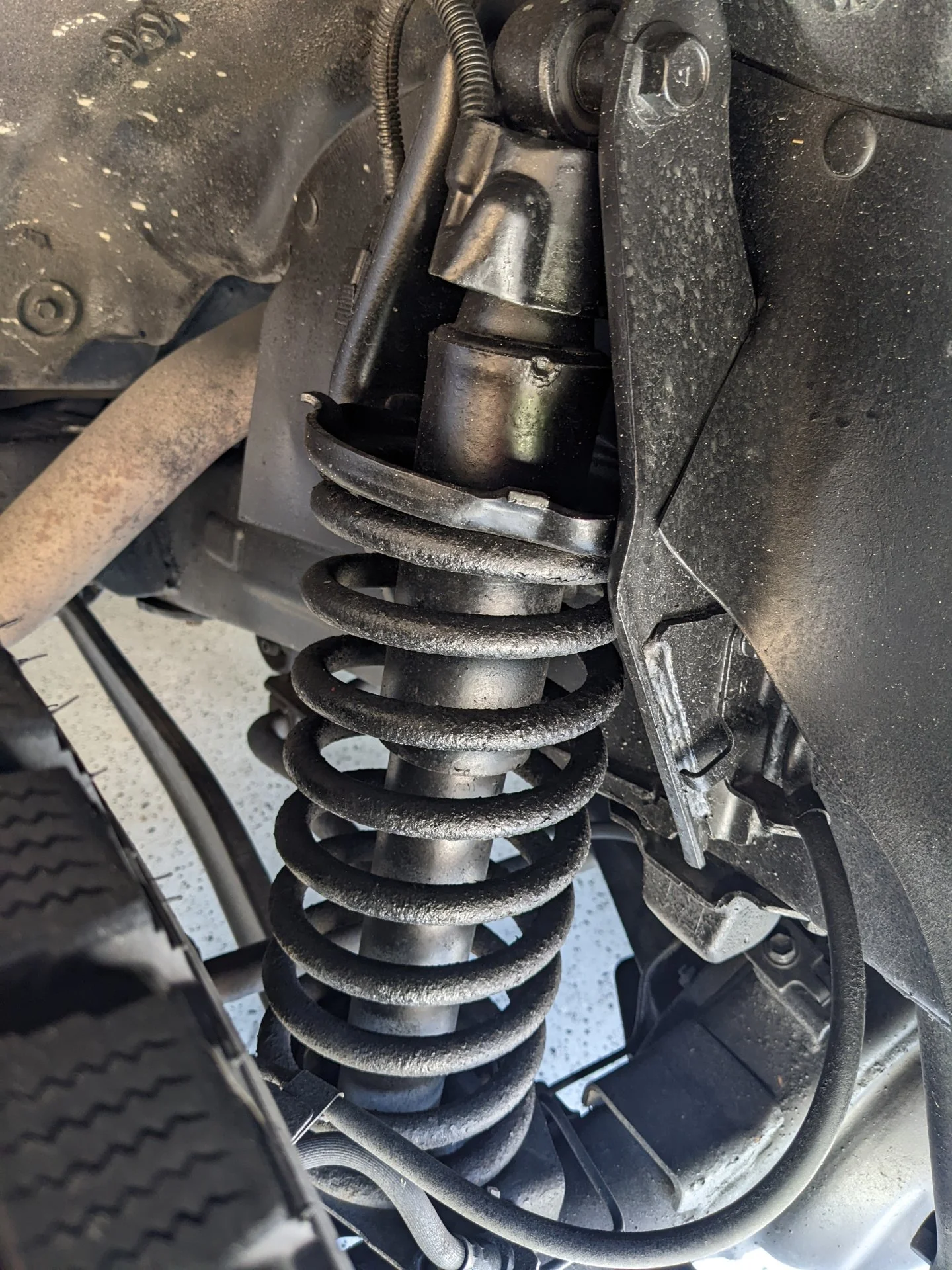

The stance resembles a lifted truck, but I'm not sure. The shocks have an electric connector on them (sounds like stock shocks) but the coil springs have traces of pick color under the Japanese undercoating.
Please help me identify what I have. Some measurements on a lifted or stock truck would be very helpful!
Cheers!

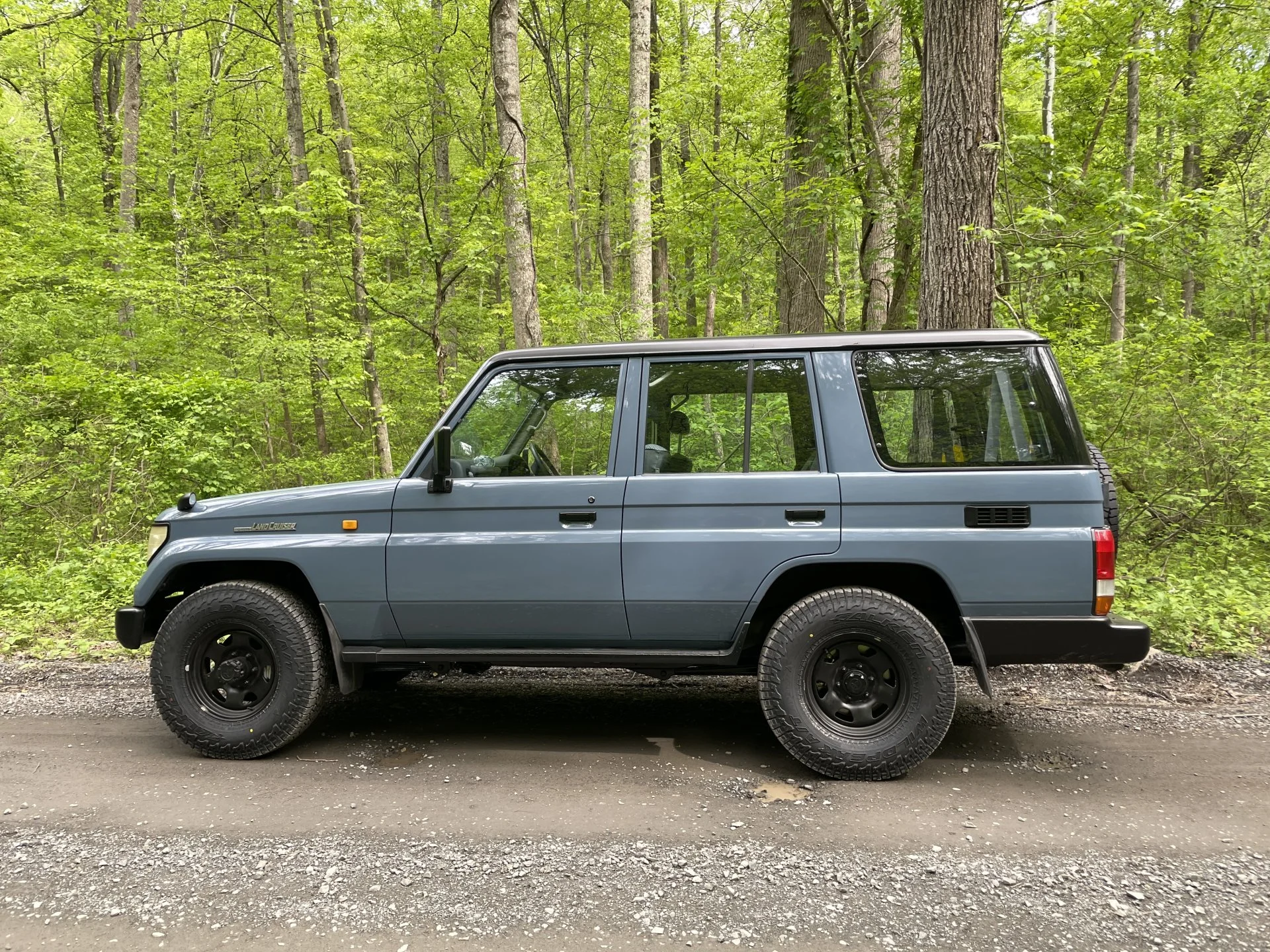

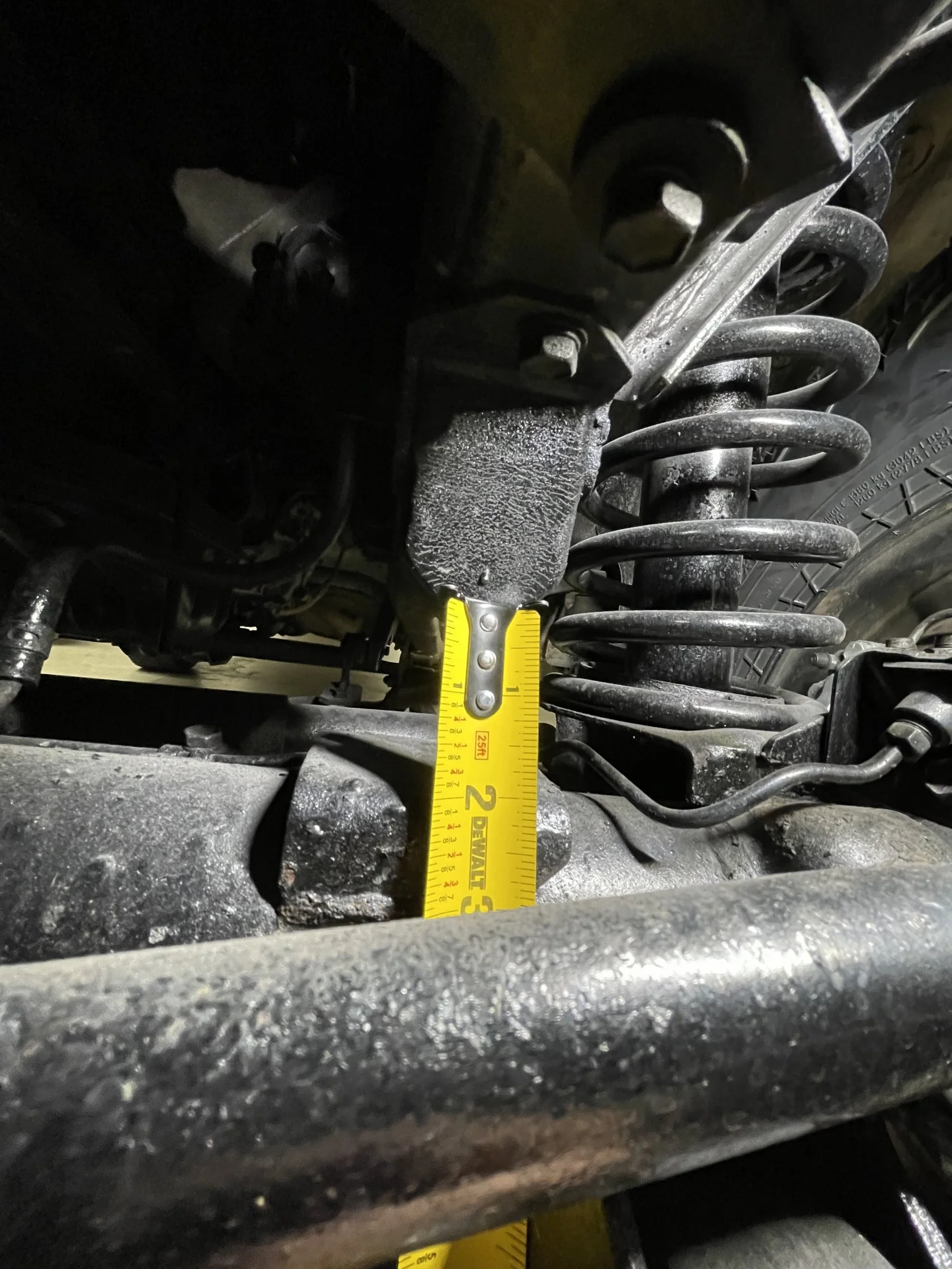

I have a 1994 KZJ78G with 24,xxx kilometer. 16 inches rims with 235/85/R16 tires.
2 inches from front axle housing to bump stop.
13 inches from floor level to crossmember bar.
I hope this helps!
Thanks @oemhardtop ! This is definitely helpful. Also, nice rig! 👍👍
So, judging by your measurements, my truck is lifted. I guess that explains the white knuckles on the highway lol, as I don't see any signs of caster correction measures on my rig.
Wonder if I'm running OEM shocks though? As I am confident that the electric response switch is functional and does effect the shocks response.
Interesting... Any opinions?
No problem. I think you have OEM adjustable shocks with aftermarket springs. If you look at the picture below of the OEM adjustable shock and the top hat shock is very identical as your.
The OEM adjustable shock part number is 48511-69425.
Awesome!
I believe that you are correct sir. My shocks look just like the one in the picture. Didn't know you can run taller coils with these...

You have about a 2” lift with original shocks. I’m not surprised your shocks are tired, my first LJ78 blew its shocks at around 160k km, my current one had worn out rears at 107k. They are kind of cool but aren’t known for lasting very long. I would recommend getting some quality aftermarket gas shocks like the Old Man Emu Nitrochargers.
