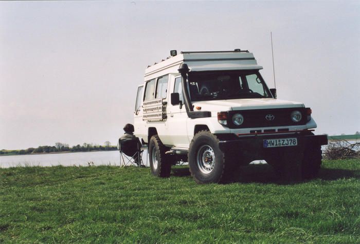

Hey,
you also have to pay attention to your rims, if you dont want to spend too much money in the moment ....
stock rims
as split rims are available in 5.5" and 6.0"
normal steal rims are
6.0"
6.5" in two designs
8.0"
for the 285 you will need 8.0" rims,
265/75 will work with 6.0" but 6.5" would be better...
(the hight of 265 will be aequivalent to the most common 7.5R16)
