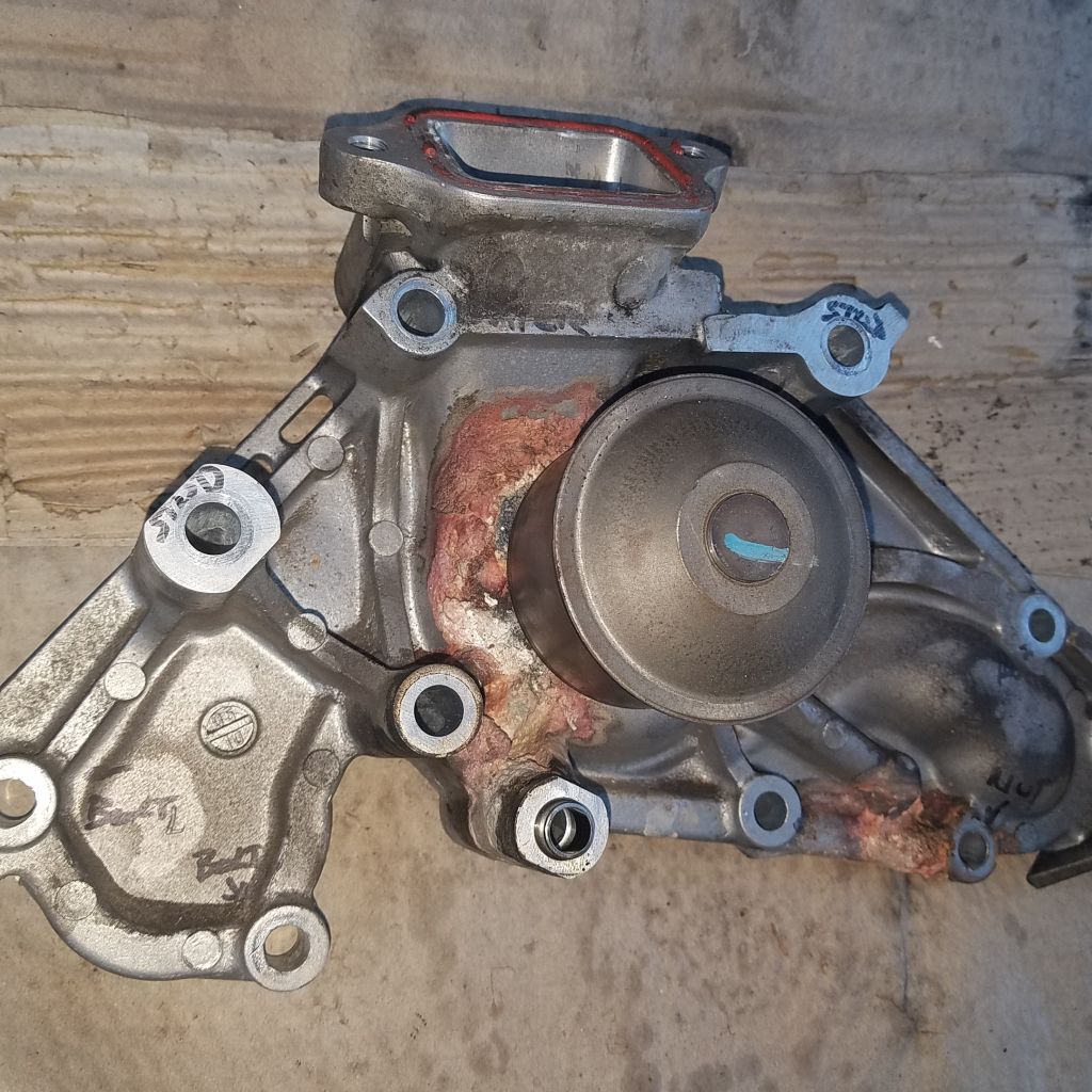

Here's my genuine Toyota waterpump purchased from the dealer. 140k miles since the previous timing belt job. It had been leaking for who knows how long but not enough to drip on the ground.
This makes me feel a little better. If it is my water pump, the question how long do I have to prepare. I might have some time.
