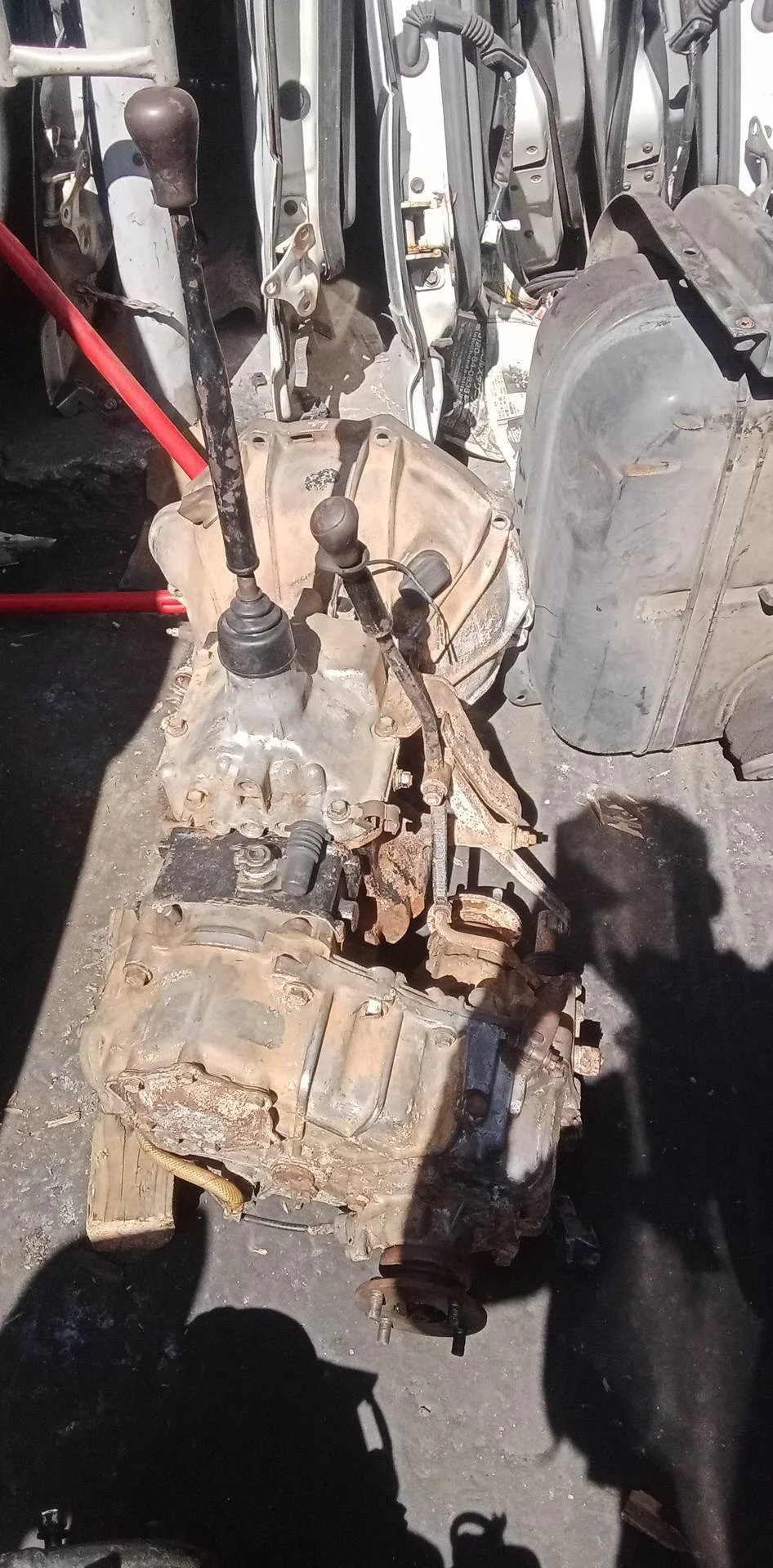

Can anyone help comfirm what this transmission is, im hoping to use it for 1kzte engine swap with a343f auto to manual on lj78 build 😑

Looks like an H41 or H55, definitely not an R151, which is what you need for a manual swap in a KZJ78.
For reference, this is what an R151f and split transfer case combo looks like. Note the ribbed aluminum transmission case with cast iron intermediate plate, shifter in the transfer adapter rather than the top cover of the transmission.
Looks to be the h55 5 speed
