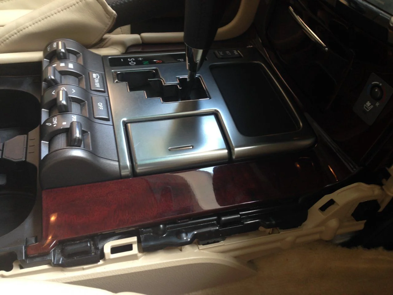

I have a 2011 LX570 and am having hard time getting the wood trim and center section out around the gear shifter. I removed the side leather panels and the ashtray section but can't easily pop out that center part. I'm trying to get the wood out to polish it and need to check if something is restricting the little door that covers the USB and acc power.
I could not find links anywhere which is surprising but perhaps I am not searching the right terms.
thanks in advance!!
Here are two pics from the side. Just need to remove that center trim section if possible. Want to be able to get underneath the little usb and power compartment.

Gray center section just pops right out. There's a little clip for the wires leading to the shifter/usb/ahc controls underneath the cup holder that keeps things tight. Unclipping that gives you enough slack to be able to remove it.
Remove the cup holder, it just lifts out. May need a little pressure. You'll be able to see the little clip on the front right if I remember correctly.
It's easiest to remove the gray center area by popping out the back ahc control area slightly and then popping up the front. Remove the shift knob and you'll have some room to start unclipping the wires connected to the gray center area. After everything's disconnected you can just lift it out.
