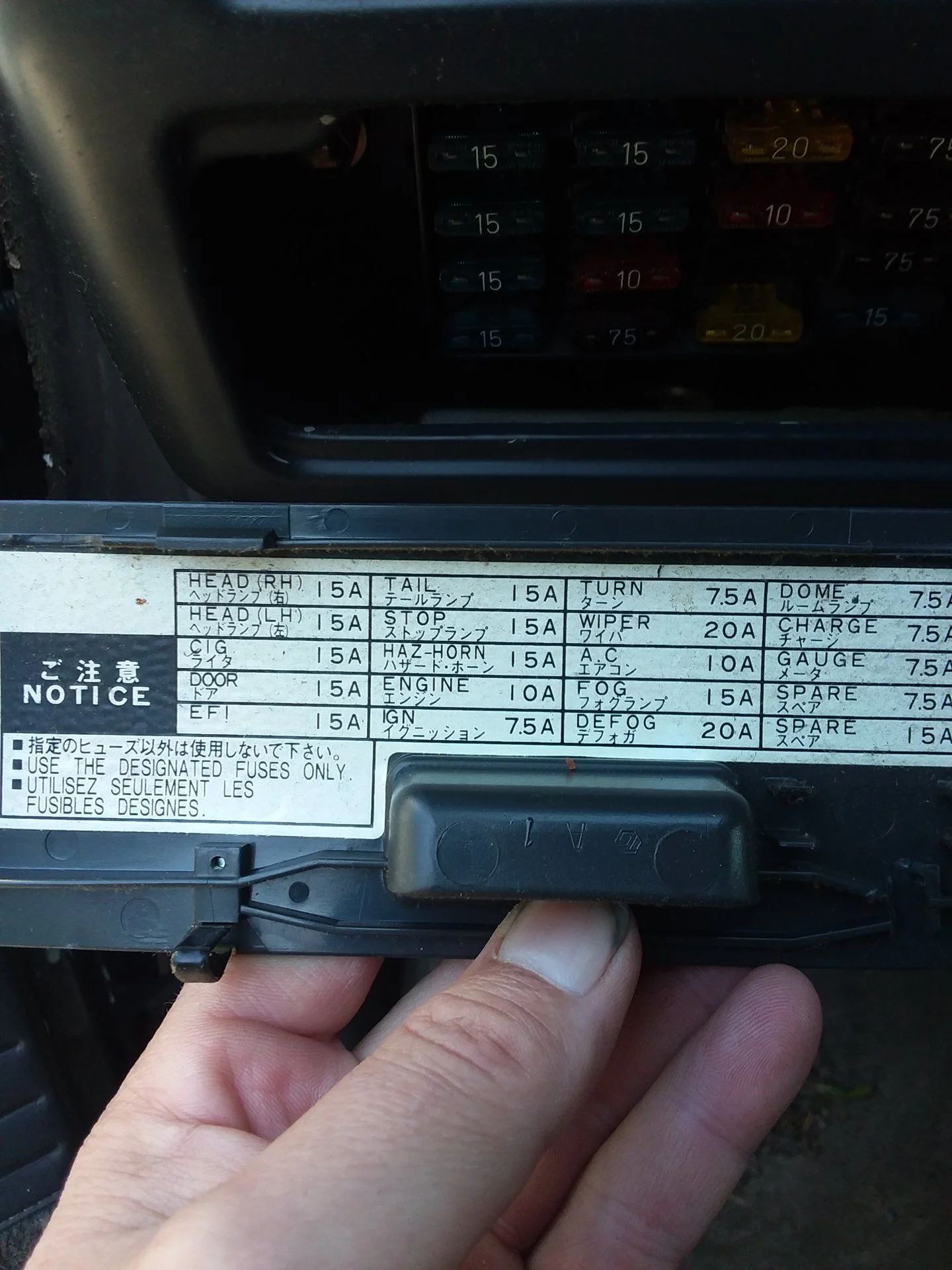

Oh, where in the world is the efi fuse? Is it called something else or am I crazy?

EFI fuse should be in the fuse box on the drivers side about knee high. Theres a cover you pull off. Should be a diagram on the back of the cover that will show you where the fuse is located.

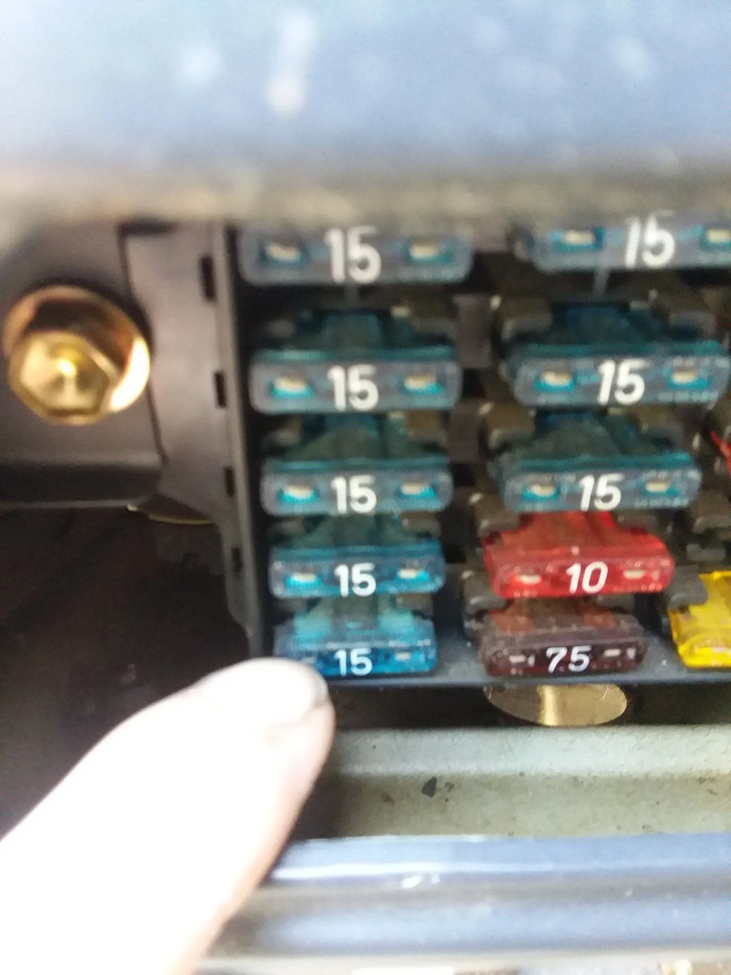

I’m gonna assume it’s the fuse labeled “engine”? Nothing says efi. Yet everyone calls it the efi fuse.
