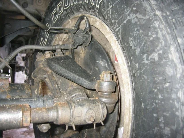

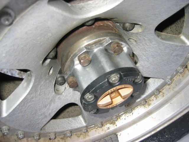

Get 2 manual Aisin hubs (you may need the cone washers/lockwashers too) new or used from a cruiser or minitruck and the spacers. The spacer resides behind the manual hub and makes up for the difference in length between the electric and manual. I'm not sure what becomes of the wiring for the electric hub though. Here's a pic of our 77 that was already converted to manual before we got it. The wiring is still in place at the rotor backing plate and I haven't had the need to pull the hub apart to see what's going on inside.

As the earlier photo shows, you will need the conversion ring kit, which should incluide ? the bolts or cap screws
and a set of manual hubs ,30 splin, if they are Aisin type then you'll need the collits to suit .
Other types don't use collits, so are pron to working loose or breaking the bolts if used with a front locker.

$260 for reconditioned hubs is a deal. Don't quote me on it but I vaguely remember replacement Aisins from Toyota were around $350 ea. :eek: Cool that you're set up. On our 77 the 4hi doesn't kick in (and dash light doesn't come on) unless both 4hi and hublock buttons are depressed. Something to do with the hublock wiring harness still being hooked up. Please enlighten me if you figure this out during the course of your swap.

The ECU controller won't let you go into 4WD with out the Hub lock button being engauged.
So when you fit manual hubs you still need to push the hublock button, as well as the 4WD, because the system does not know that you have fitted manual hubs.
You can remove the wireing from the plug on the chassis , to the brake backing plate, if you wish.
