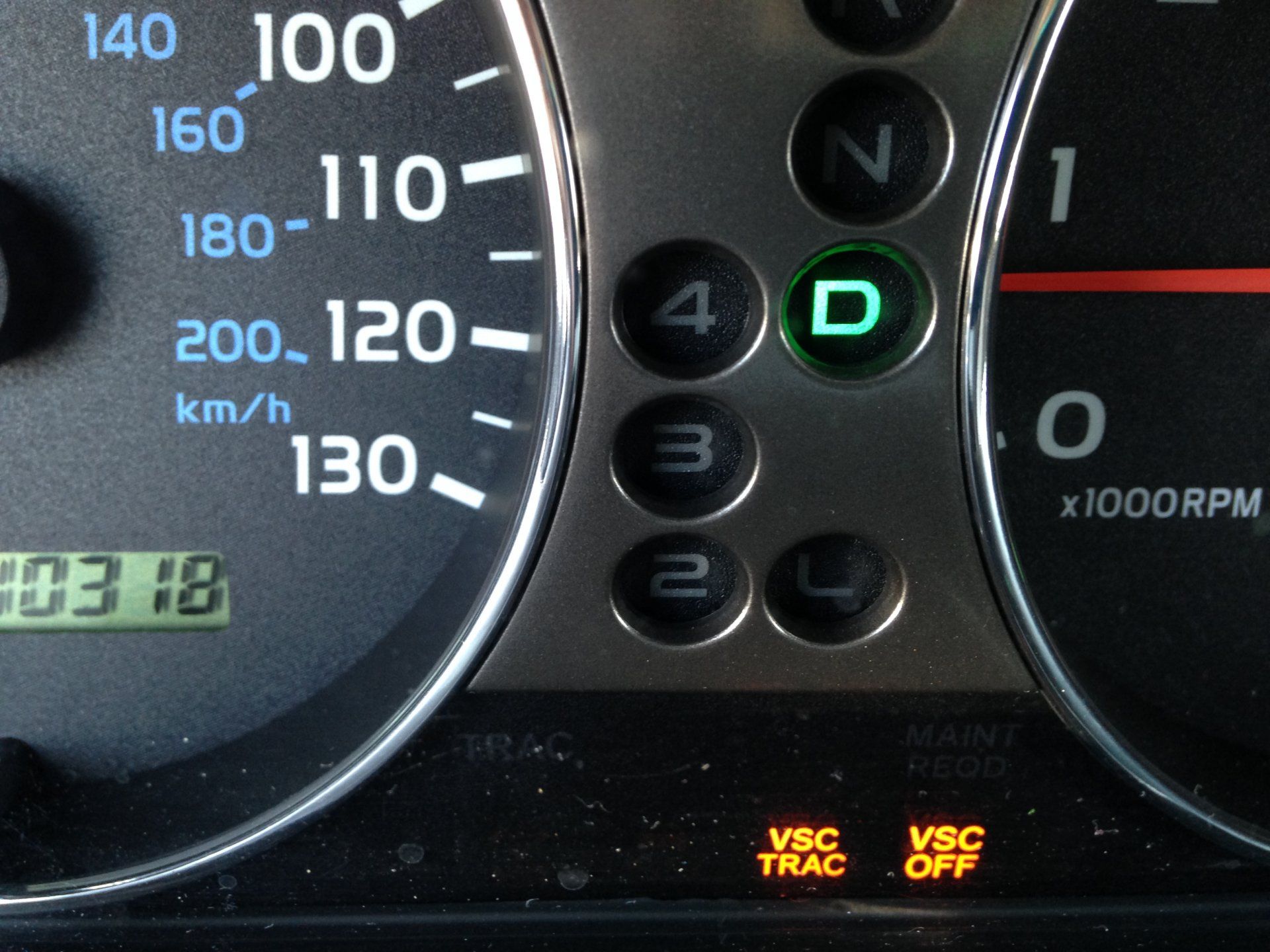

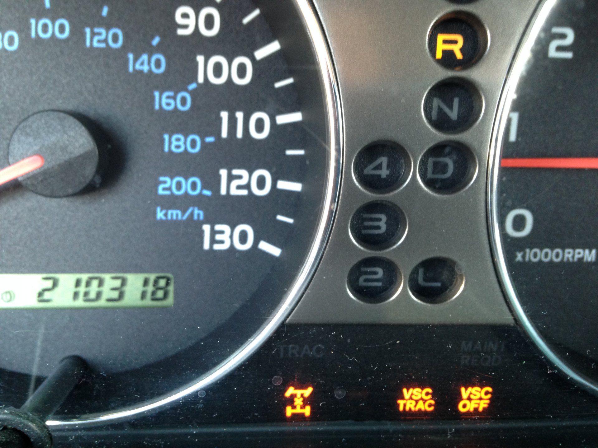

On my 2000, when the CDL is engaged and working properly, you get the diff lock light plus two VSC-related lights: VSC OFF and VSC TRAC. Never just the CDL light. Ask the seller if that is the only light that's on.

All three lights should be on when engaged. The steering will noticeably scrub at low speeds.
Disengaging will turn all three lights off starting with the CDL. Sometimes VSC and TRAC stay on for a few moments afterwards then disengage.
The CDL alone should not be on as the CDL triggers the other systems.
