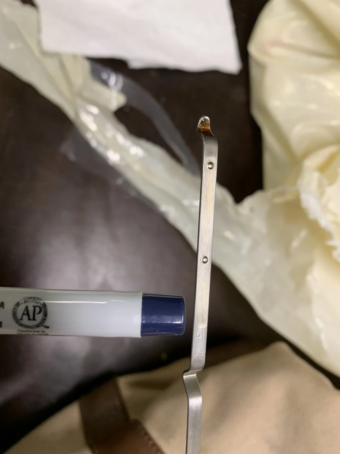

Had oil change at the dealer, came home and checked the oil level (at 52 years old, I guess I have a few quirky habits)...attached are 2 pictures...the first picture, with the Pen pointing to the level (used the pen as pointer as the hot 0W20 oil is hard to pick up with iPhone camera)...this was take a few minutes after hot engine shut off. Reads about 1/2 inch above 'full' mark on dipstick.

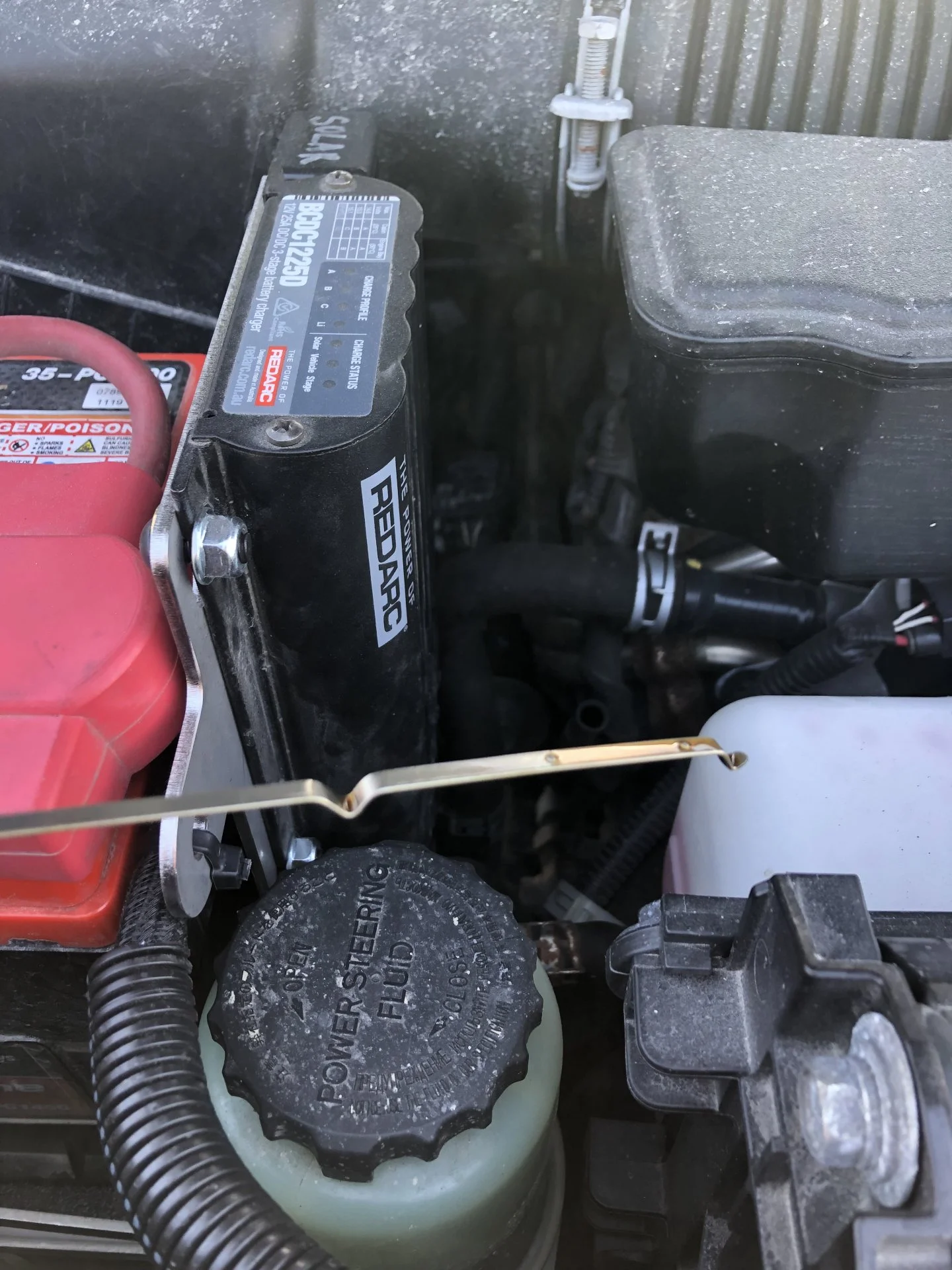

The second pic is from the morning, cold car, sat overnight...no pen as an indicator as the oil is cold and more viscous, much easier to see level in the pic...this shows the level MUCH MUCH higher than the full mark on the dipstick.
Called dealer yesterday, very nice...Sr Tech felt the car has about 3/4 quart too much oil..this was based on the first picture, hot engine...I have not showed them this mornings pic yet...

I think your engine has the wrong dipstick!
I have a 2013 LC purchased new in 2012 and should have the same dipstick as your 2015, but it doesn't. My dipstick - and every other LC200 dipstick I've seen - is perfectly straight with no "kinks" as shown at the end of yours and another one above the full mark.
What does the handle of your dipstick look like?
In any event, I wouldn't panic, or do anything about your oil fill level, until you can verify that you are using the correct dipstick.

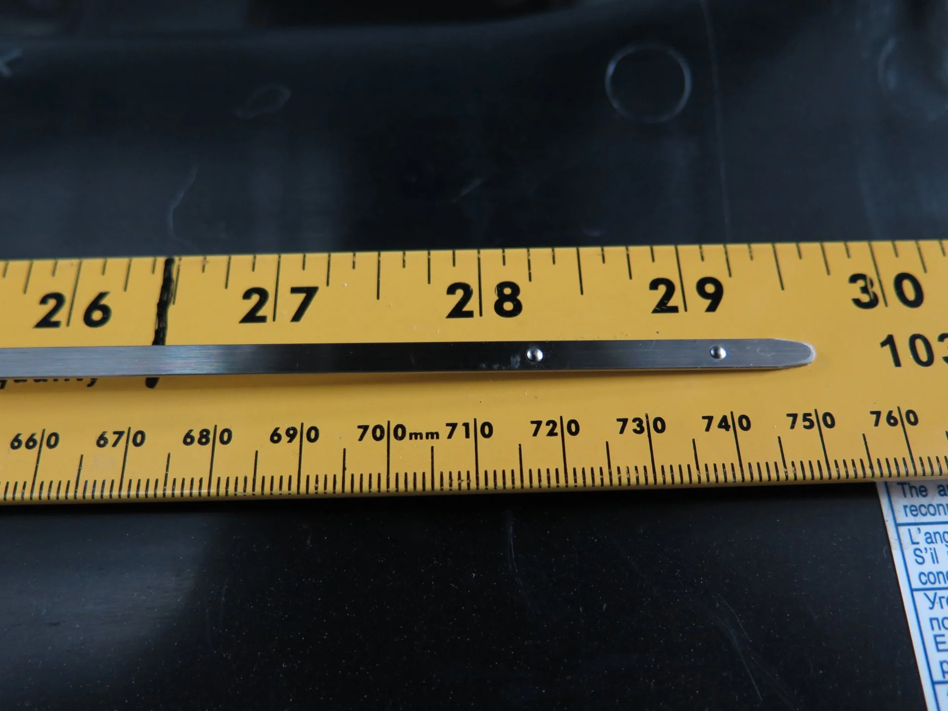

For reference, here is what my 2013 LC200 dipstick looks like:
Bottom end:
Top end:
If your dipstick does not look like this, or is not approximately 29.5 inches long from the top of the handle to the end of the stick, then you most probably have the wrong dipstick and should not trust the readings.

My '13 200 dipstick has kinks and bends like the OP; the dipstick for my 2000 UZJ100 is straight.
*I* would drain it start over - based on what I remember reading about overfill in the 100 forum years ago - it may not do damage, but depending on the amount of overfill - is beyond design spec and could cause expensive problems.

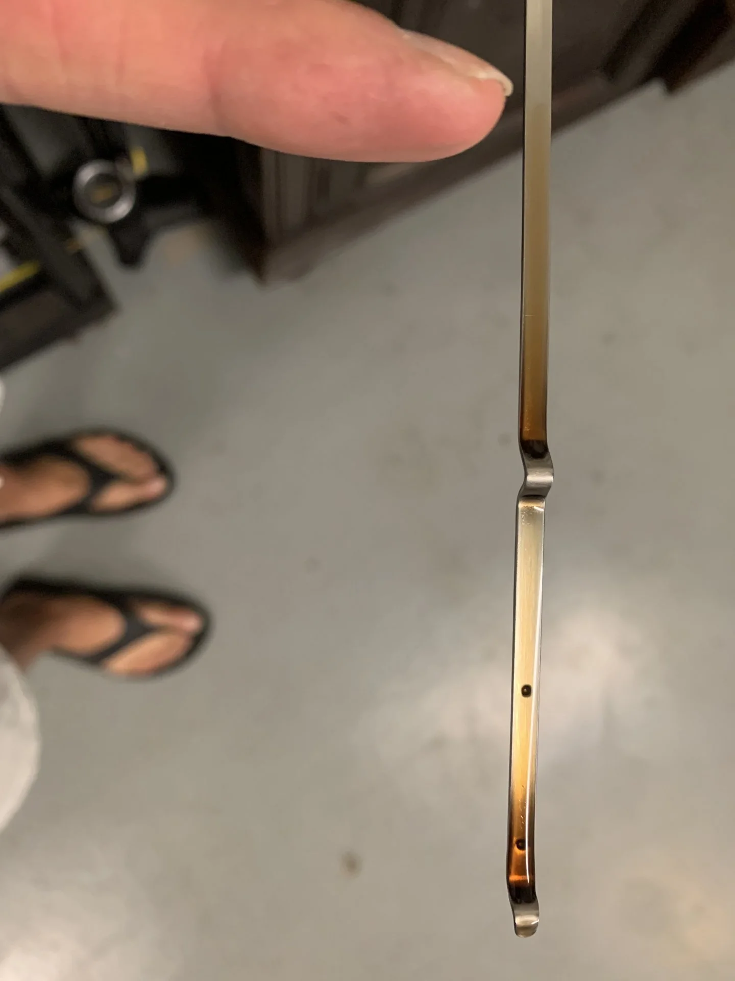

Checked the dipstick in my '15 tonight, it looks exactly like the one that @acastell posted photos of, with the little kink and the bent tip.

Anyone else out there with a straight (no kinks) dipstick on their 2013 or earlier LC200? Inquiring minds need to know.
