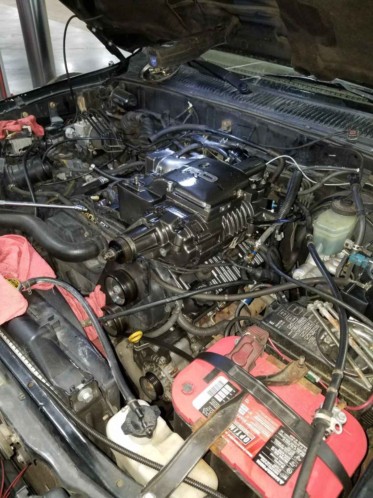

    Nice. If the motor has sludge it could be a ticking time bomb. Could last another 200k or 5k depending if a chunk breaks off and clogs a oil passage. But used 3.4 motors are cheap and plentiful. Rear axle seals often leak at high mileage, and rear wheel bearings start to go around 300k. If the radiator looks old I would replace it to avoid tranny strawberry milkshake-that happened to me. P0171 may just be a dirty maf sensor. As far as front brakes-its the tundra brake swap, not taco. Front ball joints are also a good idea to replace. 3.4 motors can run a long time. I talked to one guy who has 400k on it, all of those miles with the supercharger on it. Here is mine with 225k... 20170814_204835-1209x1612.jpg

    That's a good looking engine bay (supercharger envy), recent pic or is it put back together now?

    Oh OK if you have manual transmission then your fine. Another item that's often neglected is spark plugs. Not sure why being they are so easy to get too on the 3.4. Thank you, it's back together now. Was just doing valve cove gaskets.
