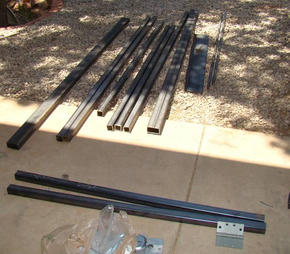

Material list:
Frame/Jamb: 5x3x1/4 Angle and 3x1 11 Gauge Rectangular Tube
Door Swing: 1 1/2 x 1 1/2 11 Gauge Square Tube
After purchasing some steel and welding and cutting help from a friend, this is where we stand now:

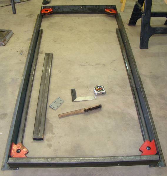

Ready to tack weld, checkfor sqaureness again, then run full beads
Angle iron welded up, hinges tack weleded on to test the door swing

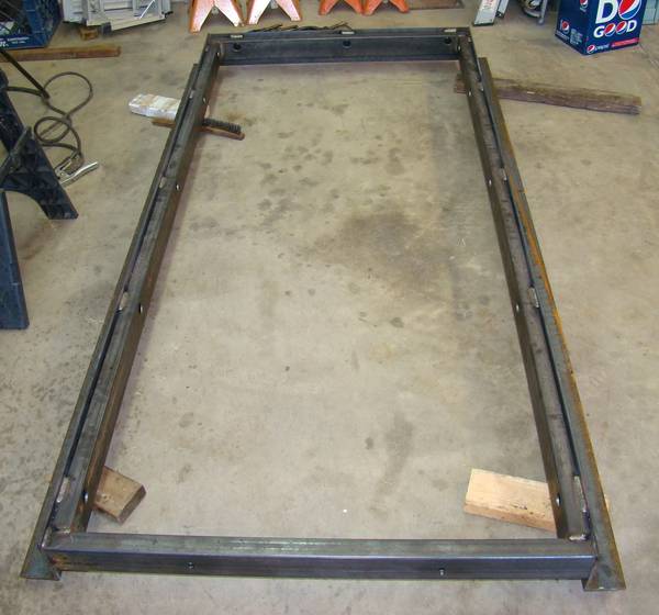

Door Jamb - 11 Gauge rectangular tube. Used a step drill to make the holes large enough to fit a socket for anchor bolts, 1.125 hole

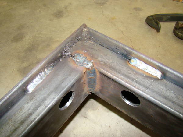

Weld Close Up

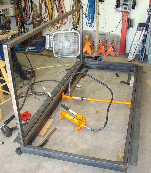

Exterior and Interior Door Frame (the middle was bowing in about 5/16, so used the spreader for now. Anchor bolts will self correct in doorway)
