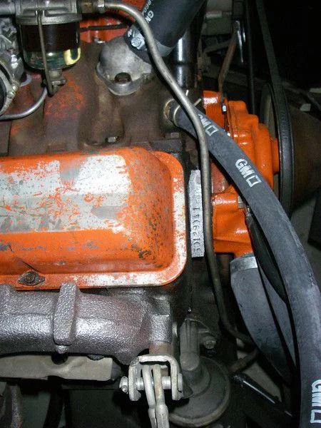

Maybe consider chaining or cabling the torque side of the engine so it stops over-extending the flexibility of the mount? I did this on an old Chevrolet. They even had "factory" V8 cables that retained the engine to the frame, but left a little slack so it wouldn't rip motor mounts in half under high torque conditions such as pulling or lots of HP with heavy traction.
You can see it attached to the manifold at the bottom of the pic. There was one on EACH side of the engine to keep it from turning upside down in the frame. The 1966 Chevy Impala had them from the factory. If I was doing lots of pulling or crawling with my LC, I would do something similar.
