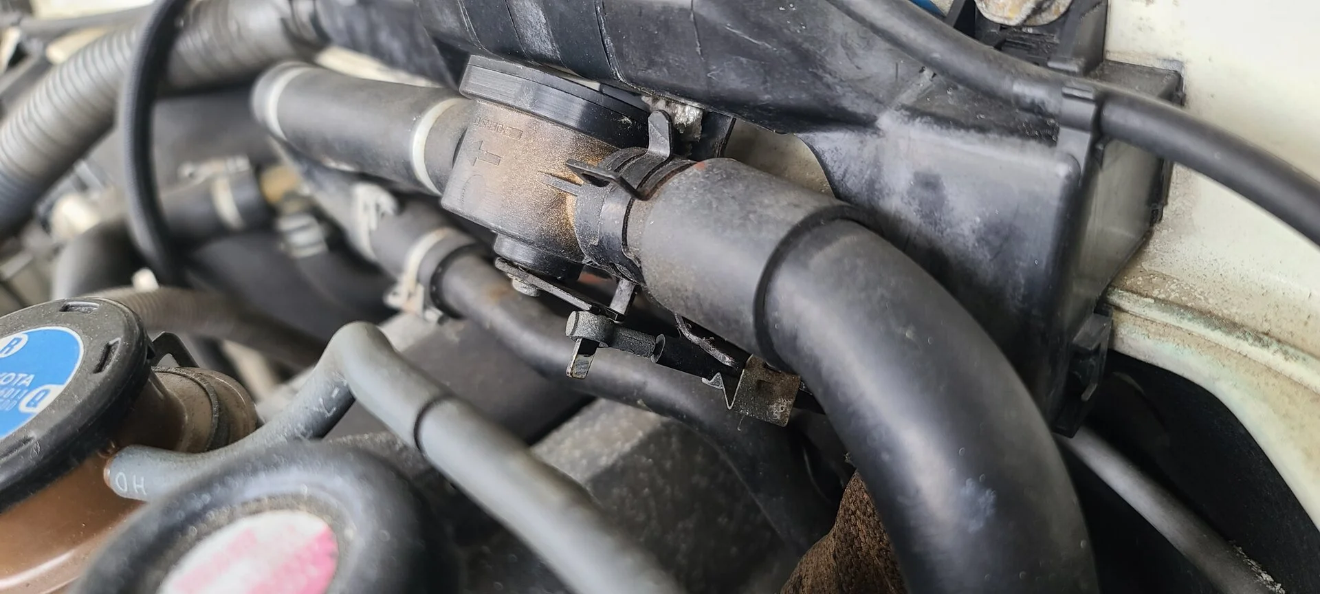

Here are the photos of the heater control valve actuator, closed (approximately 29 mm of cable exposed) and open (no cable exposed).

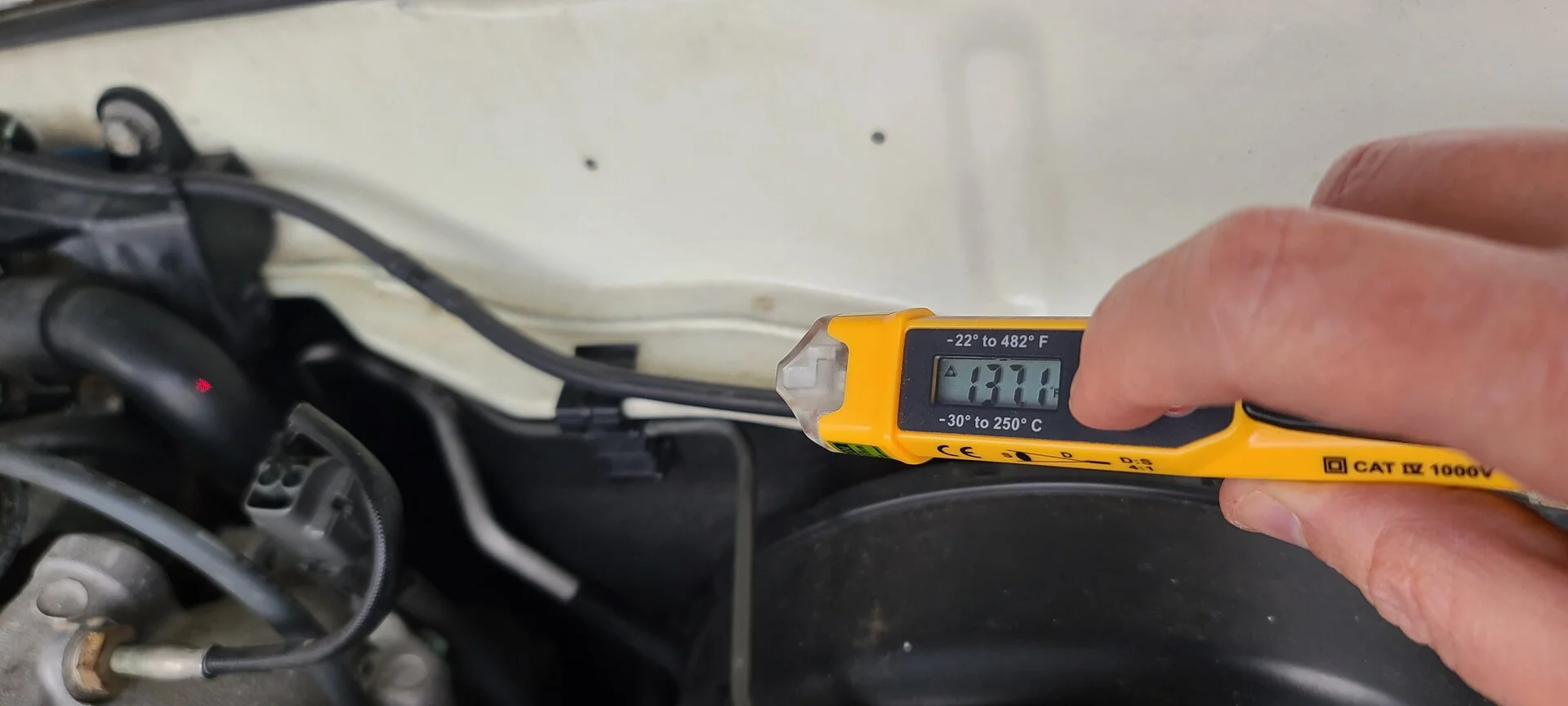

Here are the temperature observations with the heater valve closed, and then with the valve open (note the coolant flow is from driver's side to passenger's side).

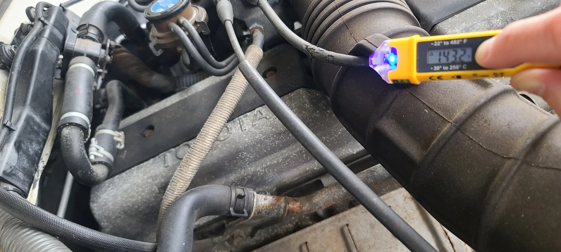

And, just for laughs, the heater core outlet hose, heater control valve closed, and then the valve open.

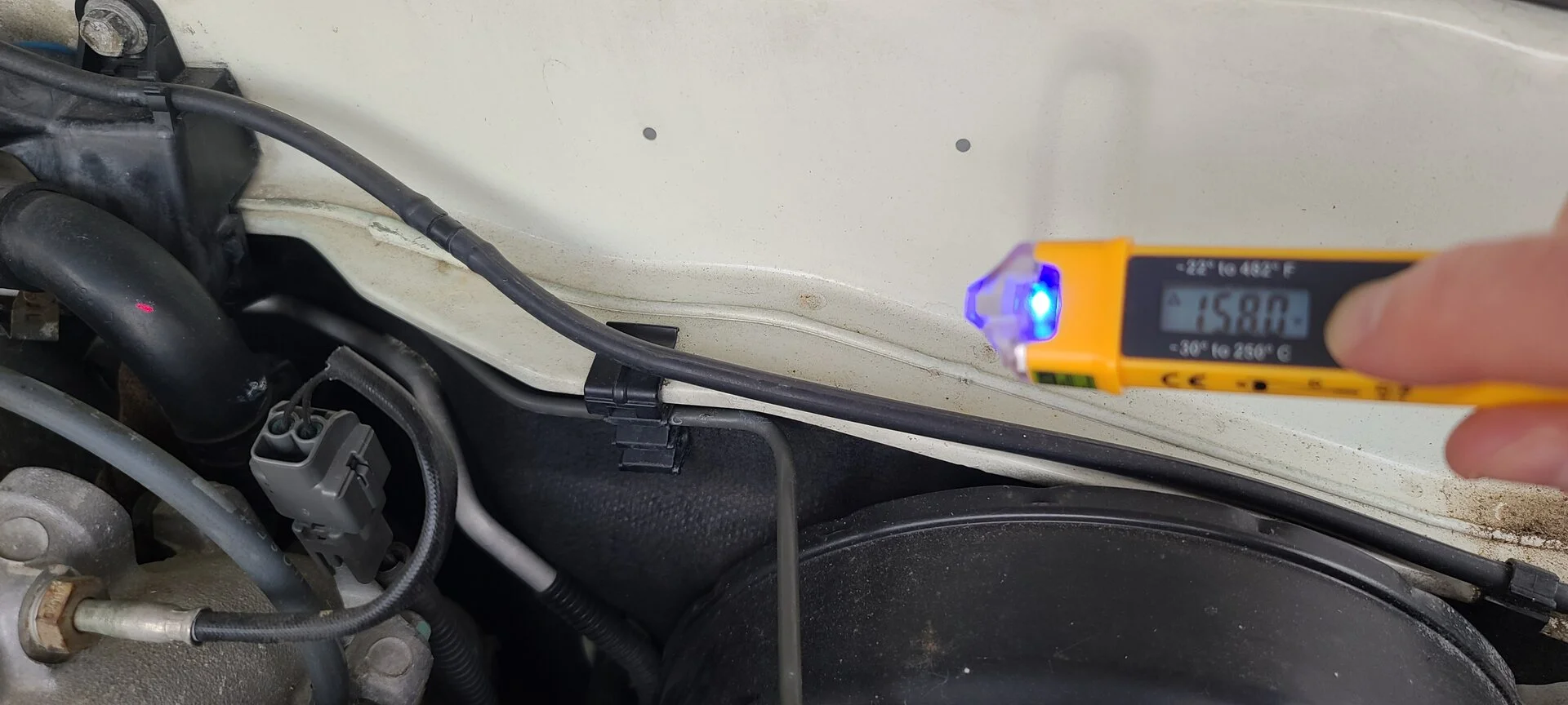

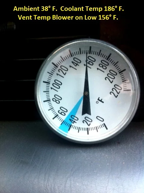

Not sure what the OP considers "Hot" but my vent temps today (not cold here) are about 158° F at the center vent (fan on low).

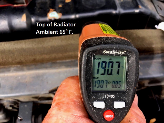

Top of my radiator (engine well warmed up) at about 190°F (vehicle sitting still and at idle).

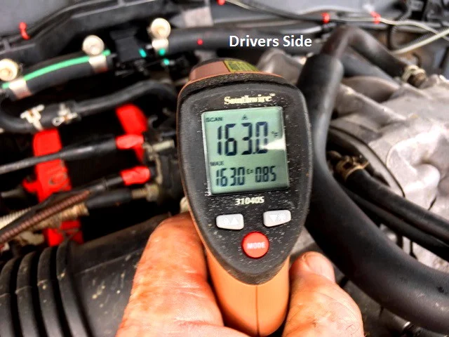

My heater valve lever from completely closed to completely open moves about 1"

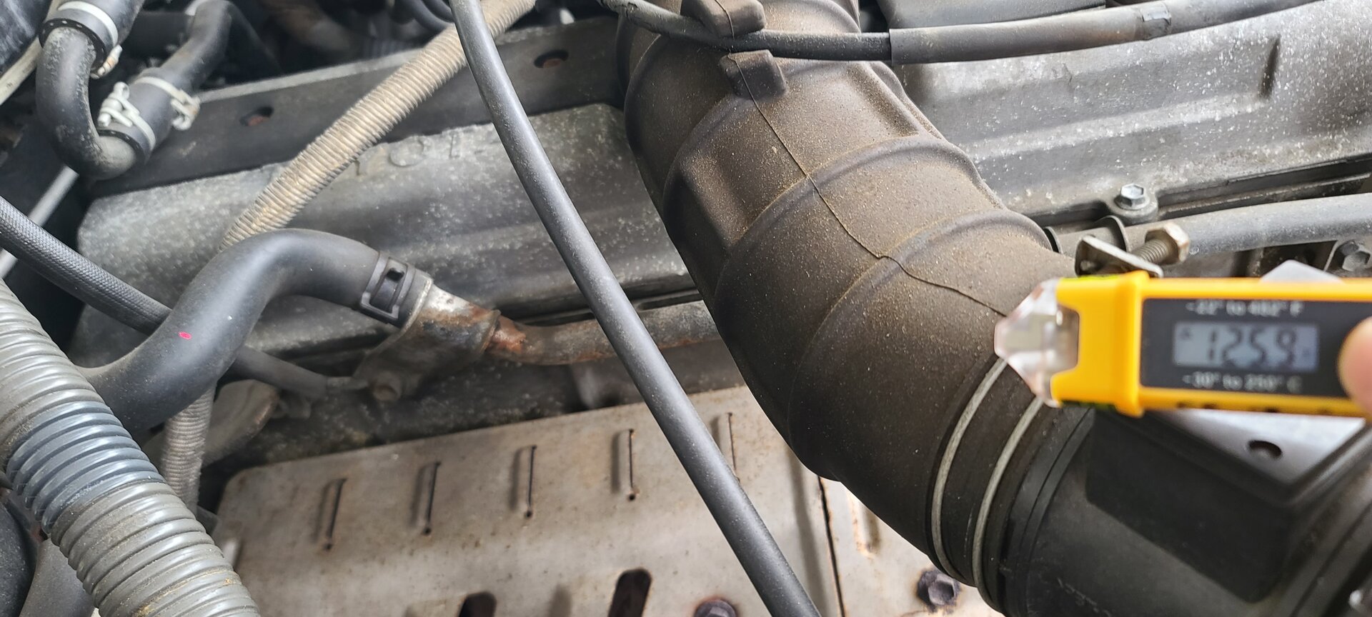

Temp at Heater Valve about 163°F

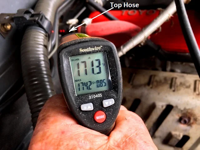

The hose that the OP says is only luke warm on his unit is about 171°F on mine. You won't hold your hand on that for long.

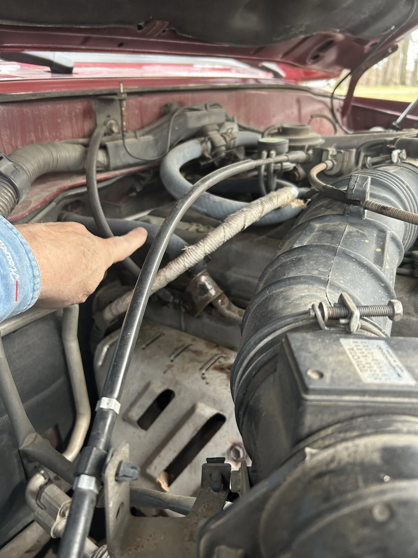

Work kept me from tackling this today. Tomorrow I don’t want to install any T’s. Can’t I just remove one of the hoses from the heater control valve and substitute it with a clear drain hose and then disconnect the hose I’m pointing too and replace with my clear input hose connected to the water hose and back flush? If that will work, which hose on the heater control value should I remove? And how should my temp control slider be set, pushed clear to the right (hot) I assume. I don’t want to flush this crud into my motor so what keeps it out of the other hose still connected to the heater valve? Sorry for being dense on this.
Work kept me from tackling this today. Tomorrow I don’t want to install any T’s. Can’t I just remove one of the hoses from the heater control valve and substitute it with a clear drain hose and then disconnect the hose I’m pointing too and replace with my clear input hose connected to the water hose and back flush? If that will work, which hose on the heater control value should I remove? And how should my temp control slider be set, pushed clear to the right (hot) I assume. I don’t want to flush this crud into my motor so what keeps it out of the other hose still connected to the heater valve? Sorry for being dense on this. View attachment 3254867
Are you only wanting to back-flush the heater core and not lose much coolant/antifreeze?

Do you have a way to measure your vent temps before flushing the heater core? Just curious what it is.
Even a small thermometer would work well enough.

Thanks for the reply Flintknapper. I would like to see some of your flint work sometime if you do knap tools and arrowheads. Can you verify or guide me on what hoses in my pic I need to attach from an input output perspective. I will also locate a temp gauge tomorrow. Thanks!
Try this
I have read that thread over 5 times I must just be inept as I still cant id the right hoses and i dont want to use Ts

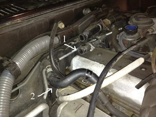

Your line off the heater valve isn't stock but this is what you need to do.
Temp controller slider doesn't matter since you're taking the heater valve out of the equation when flushing

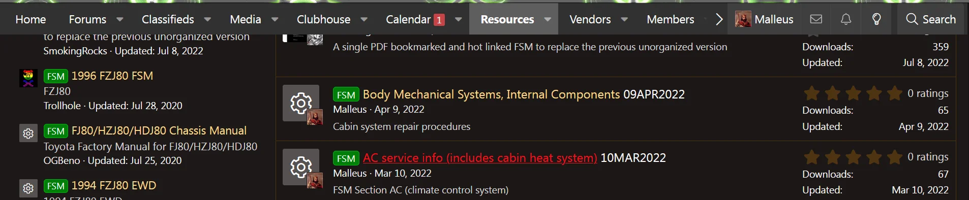

If your heater valve, on the engine side firewall, is opening and closing fully, your problem is a damper gate malfunction. The complete heater system description, troubleshooting and repair procedures are in the Resources section, as a separate FSM download.
