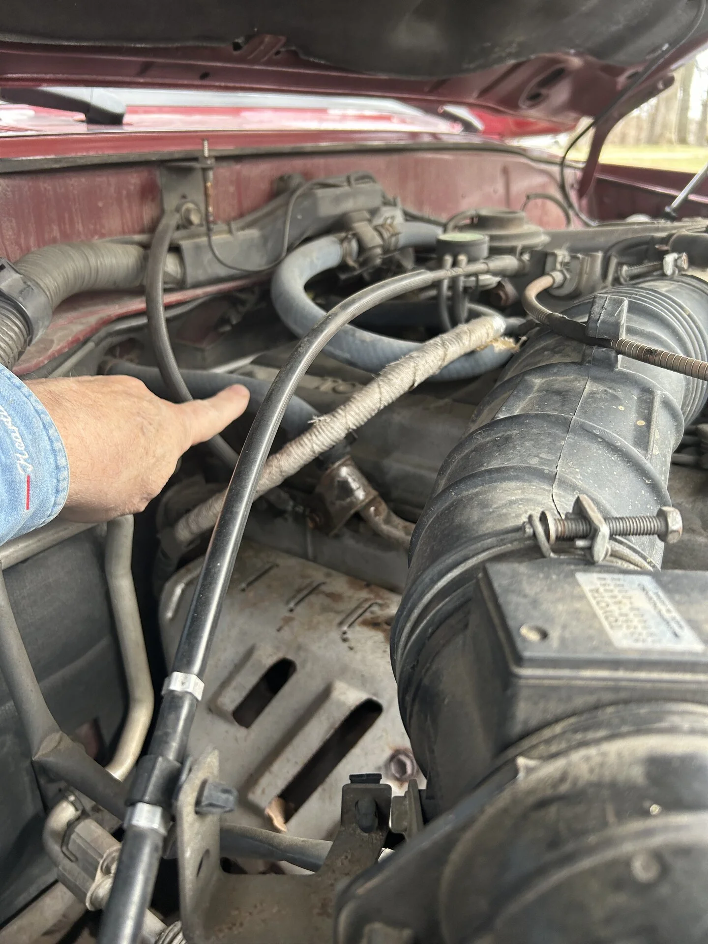

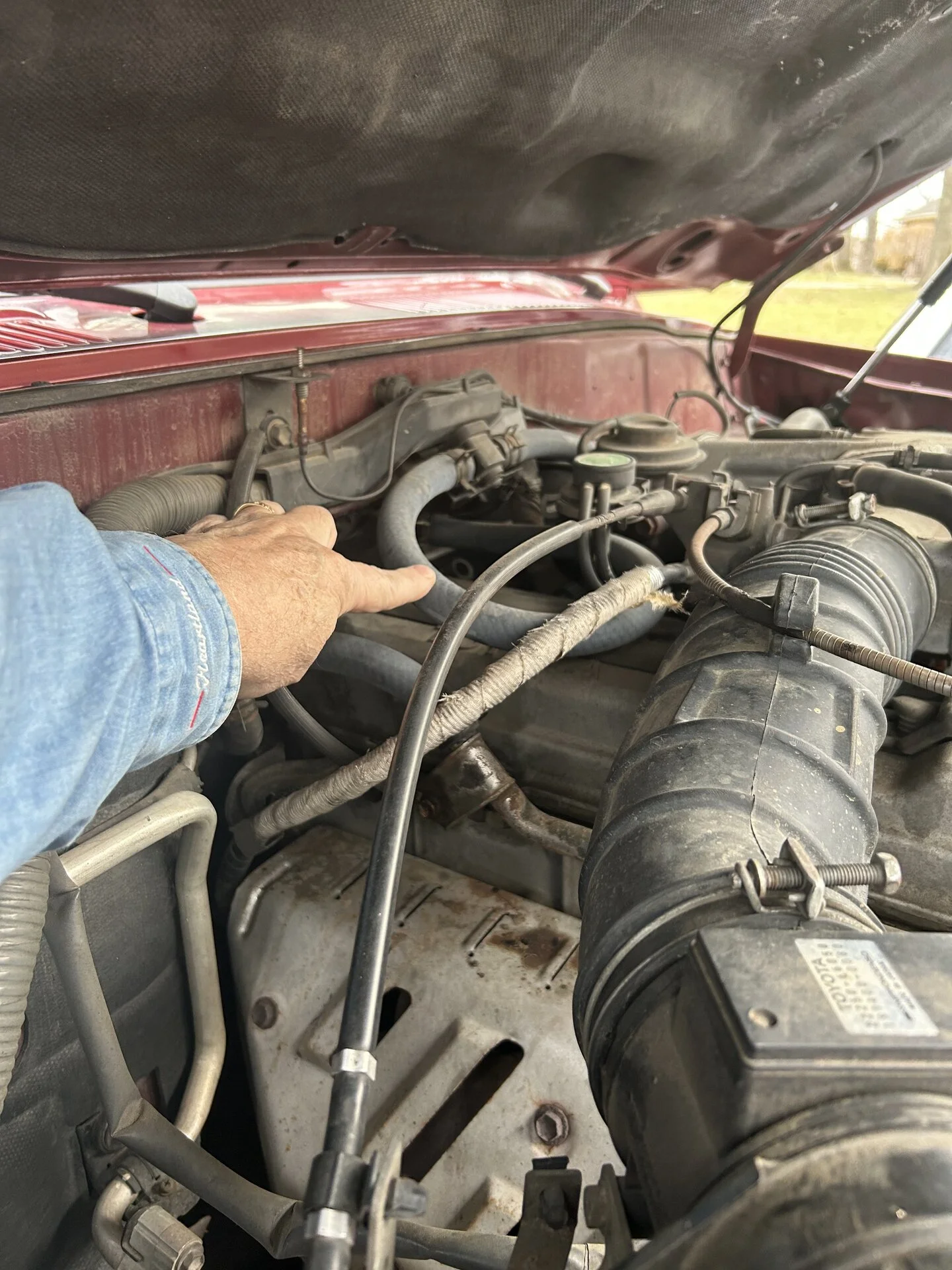

Here’s some additional datapoints that may help pinpoint the issue. The outside temp today is 54 degrees. I waited until the Scangauge registered 179 and open the hood. The hoses running through the heater valve were hot. Not burning hot but it was close to being uncomfortable when gripped. The hose I’m pointing to in the first pic is only warm. I’m assuming from this the outlet hose in the first pic by being Luke warm signifies blockage in the heater core. Would you agree? I’m also getting about 1.5” inch of travel on the heater valve when moving the interior heat control from side to side. And finally, am I at risk of anything driving the LC while I’m waiting to get time to flush the heater core. The heater is blowing warm but not hot. Thanks

FWIW, the heater inlet, from the valve should be hotter than the heater outlet; the water has lost heat once it has traveled through the heater core.
