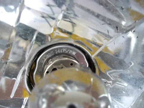

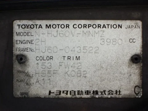

Yes I am 100% sure. I have an HJ60, with a 24v electrical system. I looked on that silver plate on my firewall which said (HJ60) and my headlight said 24v - 70w

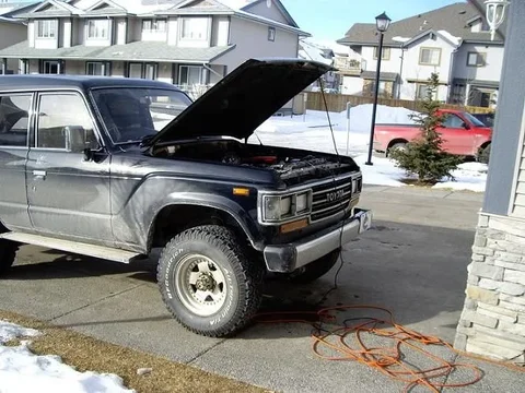

What year? Post pic?
The pictures
O.k. here are the pictures. 1988 HJ60. JDM-24v Vinplate.webp24vbulb.webpYota.webp
HJ60 ... not Canadian Market ?
As you know, the HJ60 in Cdn trim came with 12V headlights, even though the rest of the truck is 24V.
David---The JDM HJ60 (2H not 12HT) is pretty much completely 24V like the HJ61.
