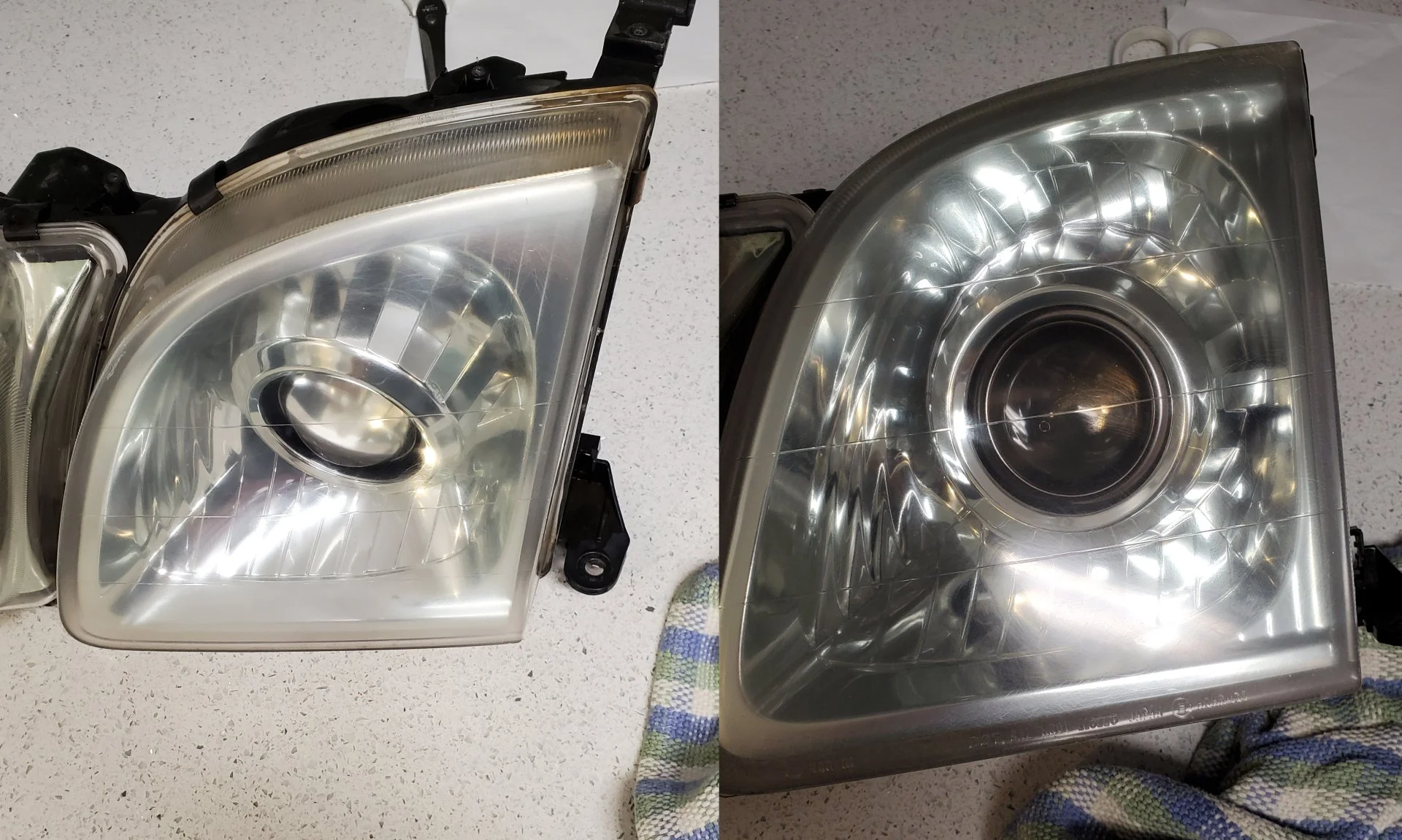

I tried steam and heat but those just seemed to strengthen the resolve of the film. Ended up pulling the headlight and wet sanding with 220grit to get it off. Then 400 - 600 - 1000 grit and finished with a toothpaste buff. Before and After:
Doesnt really look like a film to me, but maybe the original coating failing? (clear coat essentially).
What you did looks good, but would probably need to clear them again to have protection from the plastic turning yellow and fading out again.
That doesn’t look like a film (PPF - paint protector film), it’s a re-sprayed clear coat that has seen better days. You can re-spray clear coat again but only use 2K polyurethane clear coat. Or apply ceramic coating on it.
