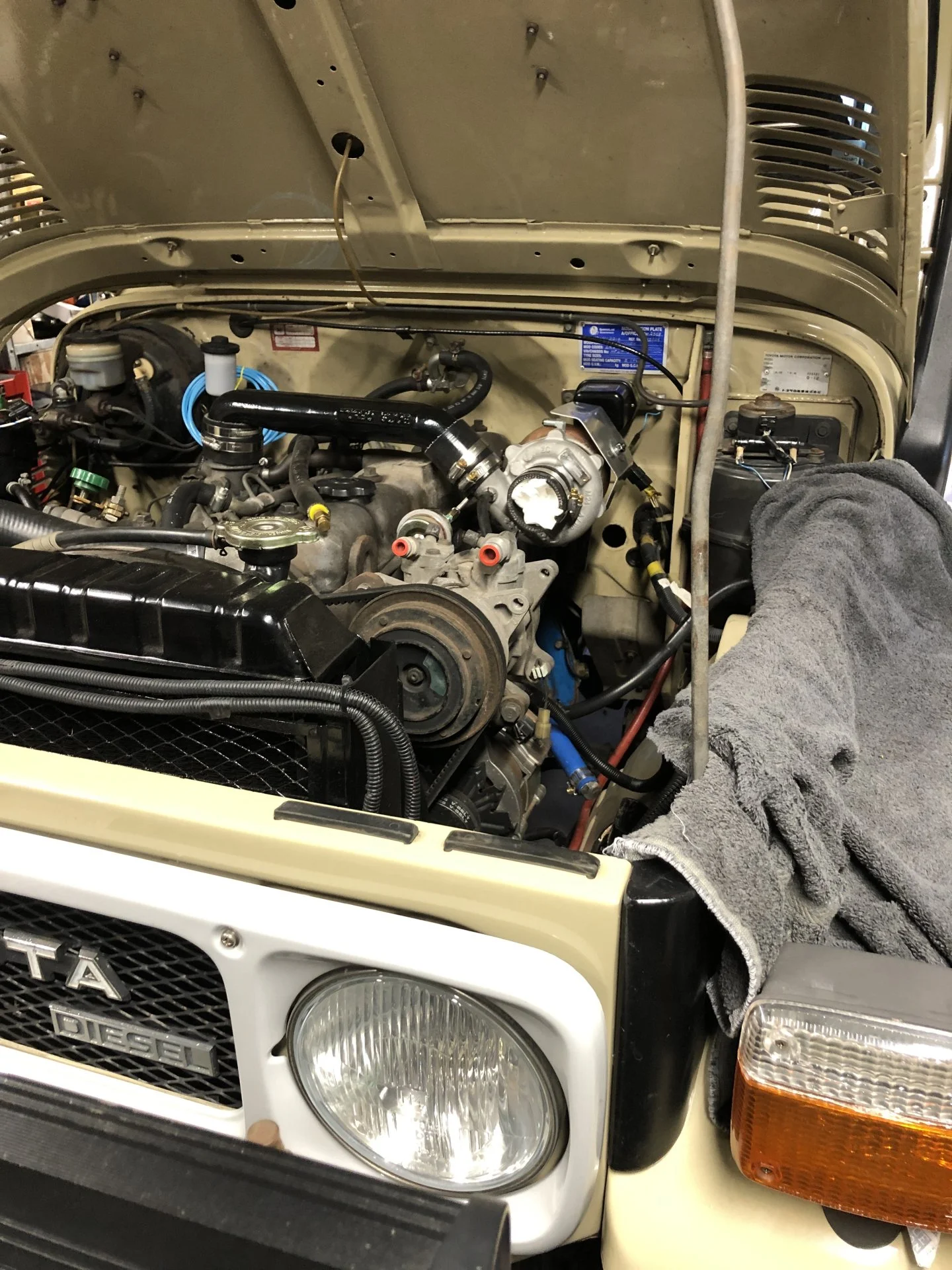

Never been closer.

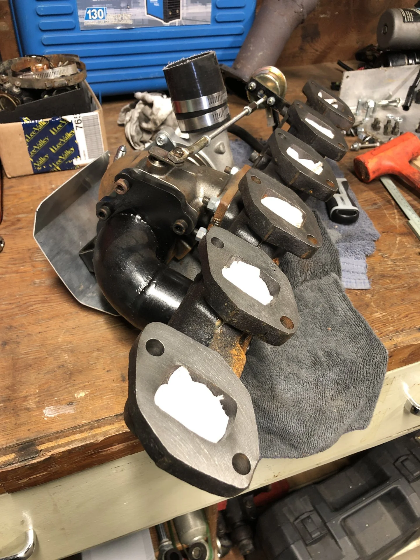

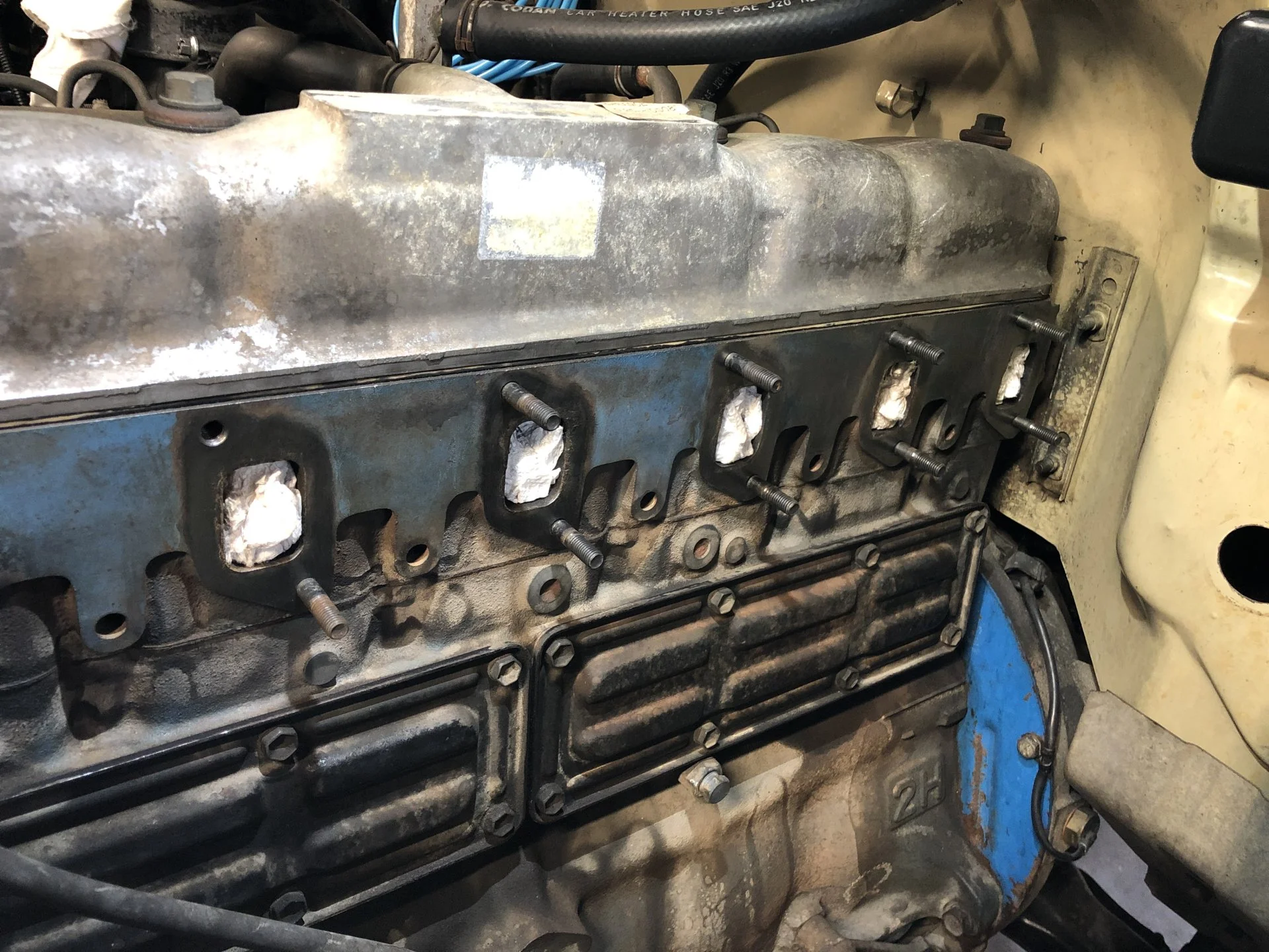

Bit of a Chinese finger puzzle getting the sequence of studs-manifold-gaskets installed.
1-3 and upper 4 studs in first or the manifold won’t clear the firewall for install.
Lower number 4, 5 and 6 studs in after the manifold was hung on the head. “Take ‘yer time” lol.
Would have been much easier to just pull the stove and do the install and slam it all back in.
Who wants to do that? Lol
So studs it is… disaster averted.
Cheers
