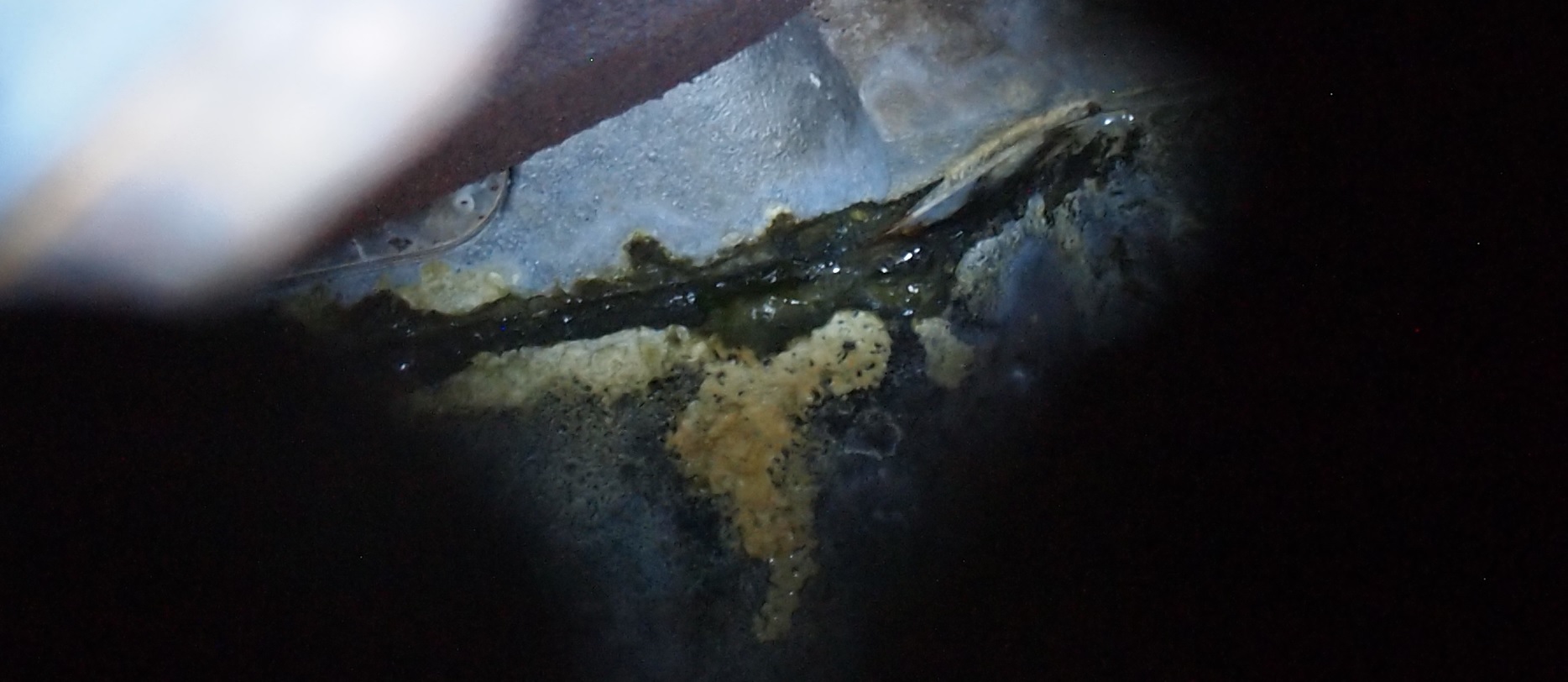

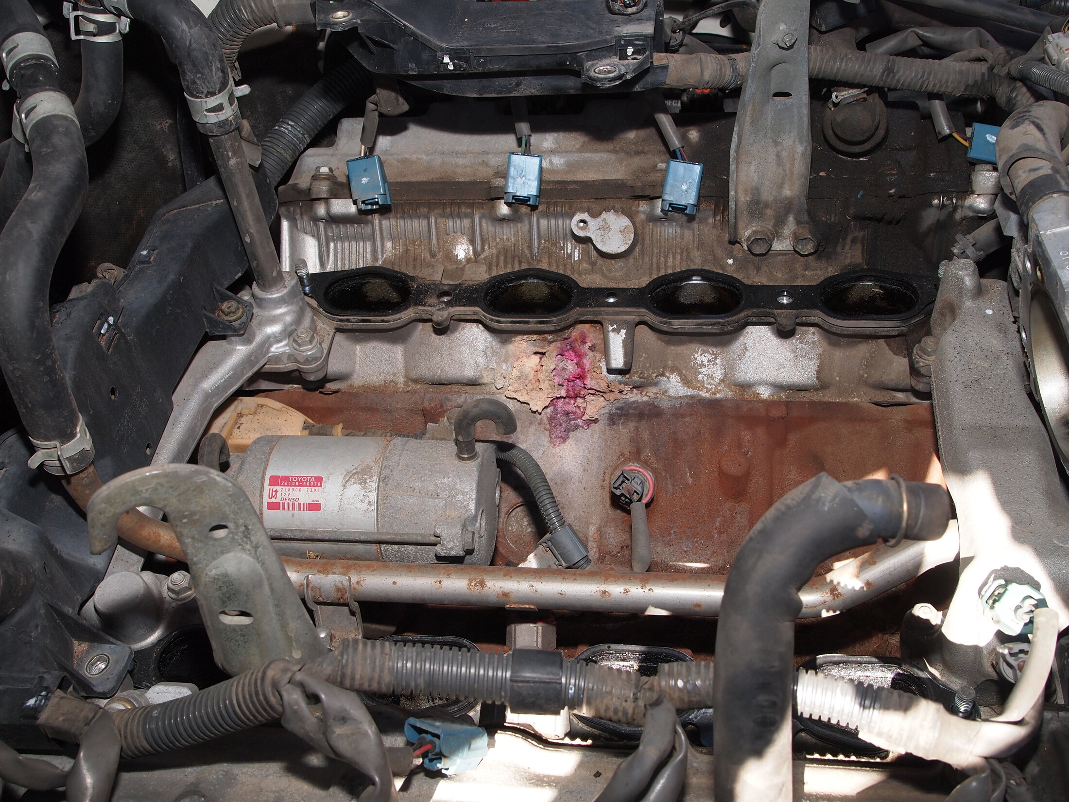

They look like these:
This was slow leak. Building thick red crusty over timer, on top side head gasket in valley. This was a warped head, allowing more coolant out top (head side) of gasket.

Here one on side of engine at head gasket. Using non toyota coolant (no red crusty). Easy to see point of leak, since wetness localized around head gasket. You can even see a little tab of head gasket sticking out.
