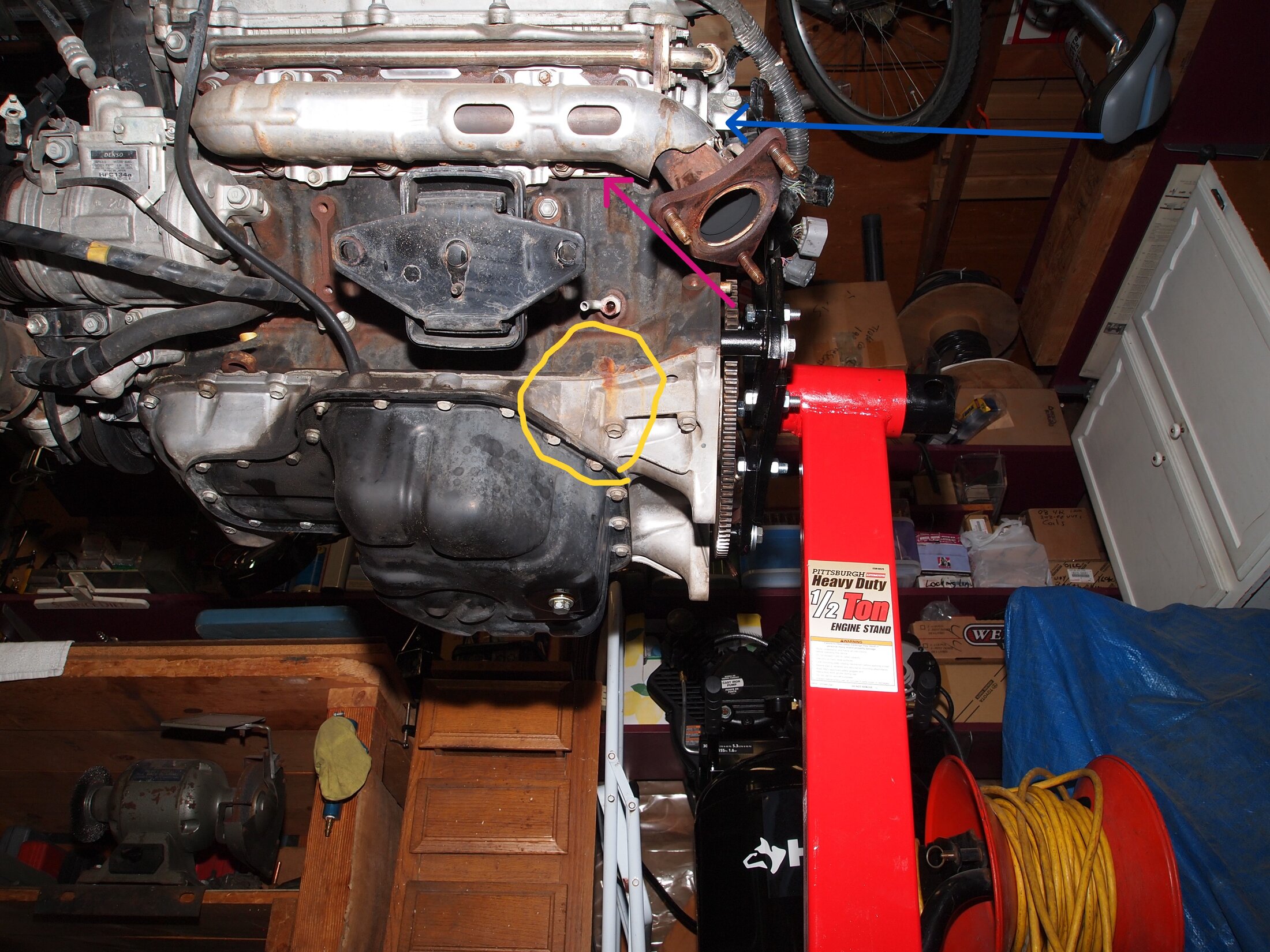

That is coolant (pinkish crusty, outlined in yellow) leak for sure.
If it is the head gasket. 99.8% chance, engine was overheated. I find water hoses swollen, 8 out of 10 times, when that happens.
But point of leak, is not shown. I'd like to see pressure test blow it out where pink arrow is pointing at head gasket. The blue arrow points to rear water bypass joint on top of engine head. It also could be a leak, and come down block. Also notice the block drain in my picture. It too could be a leak. Just forward of pick crusty, is block water hose going to oil cooler.
But point of leak, is not shown. I'd like to see pressure test blow it out where pink arrow is pointing at head gasket. The blue arrow points to rear water bypass joint on top of engine head. It also could be a leak, and come down block. Also notice the block drain in my picture. It too could be a leak. Just forward of oick crusty is block water hose going to oil cooler.
Thanks for taking a look 2001LC. To confirm: you are saying that you would want to 'see pressure test blow it out where pink arrow is pointing at head gasket'? This would better pinpoint the issue on mine? Thanks

The pressure test on my LX had coolant leak out of the driver's side, but noted that no coolant getting into the combustion chamber. The test I think was done at 15 PSI (I may be wrong)
For sure, a head gasket leak. If was spotted at head gasket (pink arrow in above picture).
