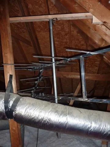

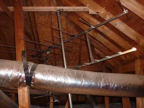

Hey all,
Just thought I would post some pics of the antenna
HD Stacker Antenna VHF/UHF/FM/digital/HD
I went with for my digital OTA signal. It is awesome the picture quality I get. I put it in my attic and was really amazed even with the ****py cable I ran it with RG6 form HomoDepot
Here they are.

I never seen one installed in an attic, cool. That would be a great thing to have for hurricane season. Not a bad price and made in 'Merica too.

did you have to mount your tv's upside down to match the antenna? J/K
