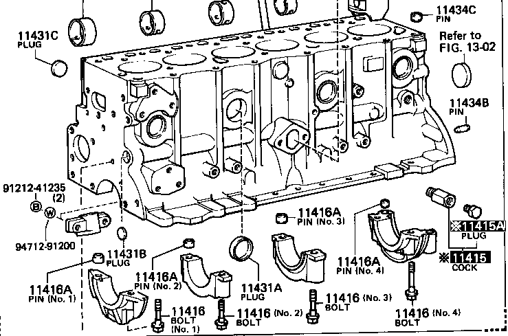

Cock, sub assy - water drain:
90/01-92/12 90910-09088 subs up to
92/12-97/05 90345-52003
97/05-98/01 90910-09075
Plug, for the drain cock:
90910-09087 90910-09087 (for a whole host of applications and years)

Is this drain plug you're after? From the EPC:
90910-09088 or 90345-52003 for 9001-9212 1HDT and 1HZ - COCK SUB-ASSY, WATER DRAIN (FOR CYLINDER BLOCK)
90910-09087 for 9001-9212 1HDT and 1HZ - PLUG, WATER DRAIN COCK (FOR CYLINDER BLOCK)
