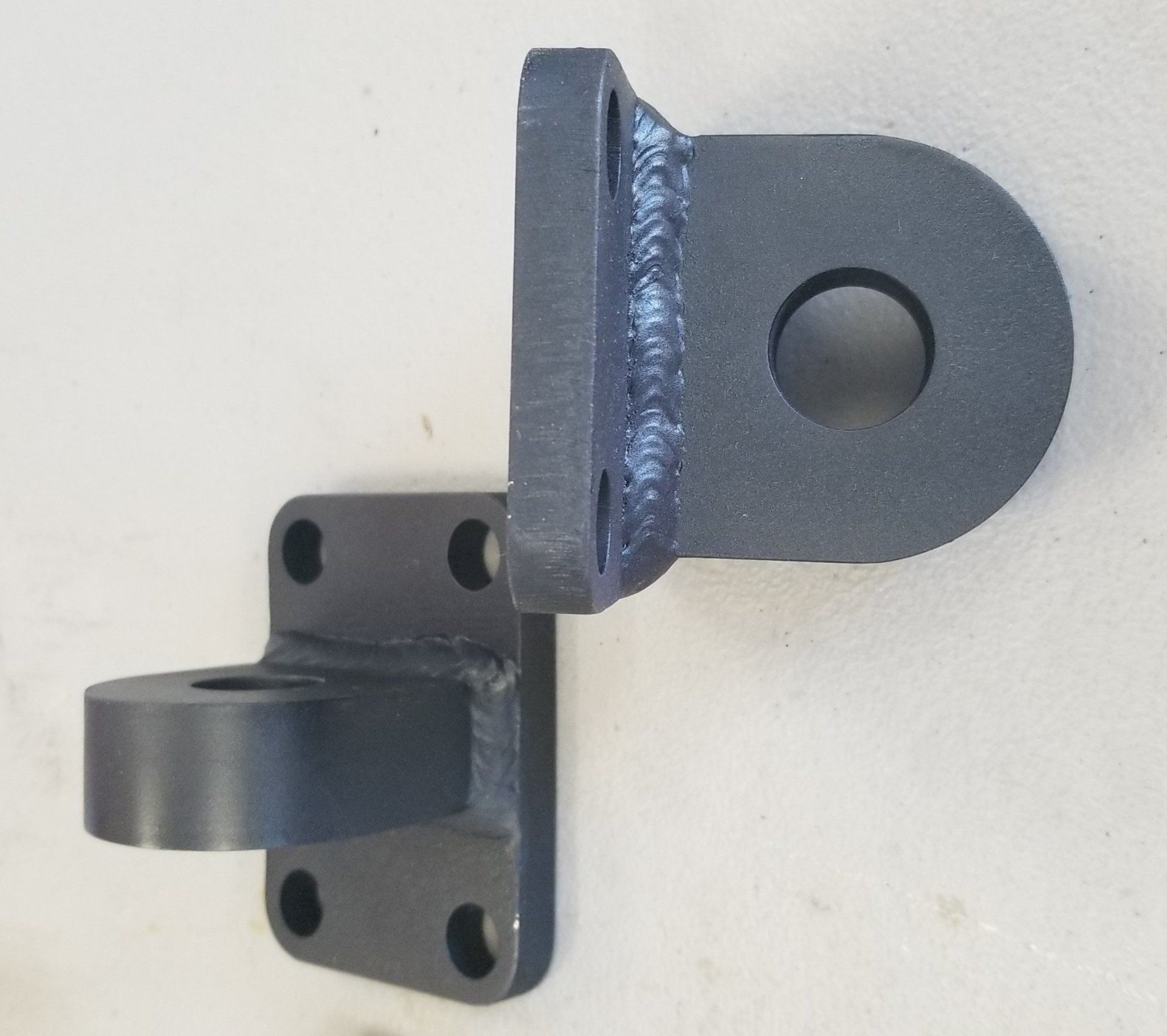

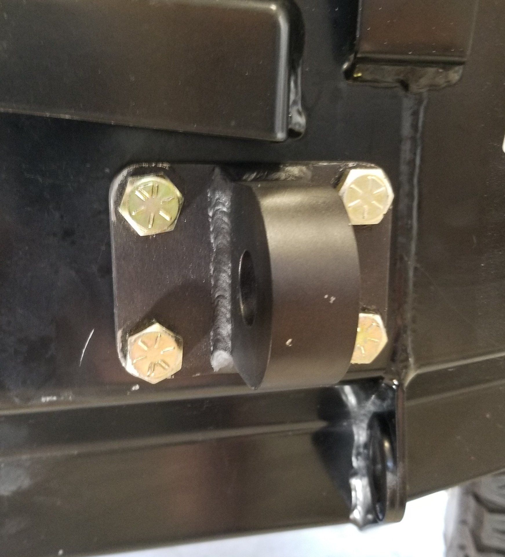

I added external recovery points over the weekend to my ARB bumper. Mixed reviews using the ARB bumper eyelets. Grade 8 bolts, 1/4 inch backing plates. Took longer to drill the holes than it did to mount these. Primed the new openings before mounting. $110 all in.
