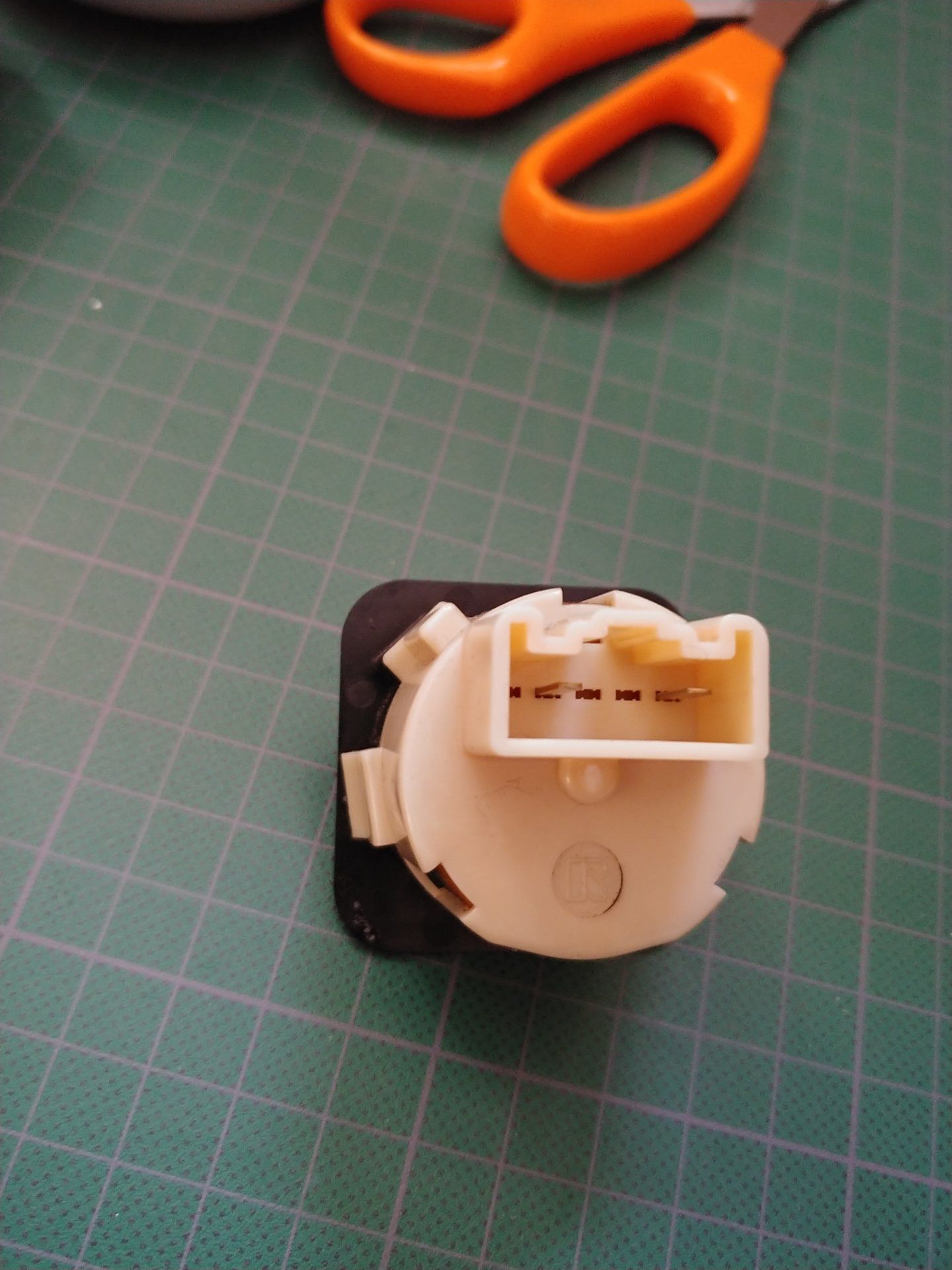

OK, I managed to change the joystick illumination bulb, but the mirror folding button bulb, I can't see it :(
Can anyone have a look please, is it supposed to light up too? Where could it be then?

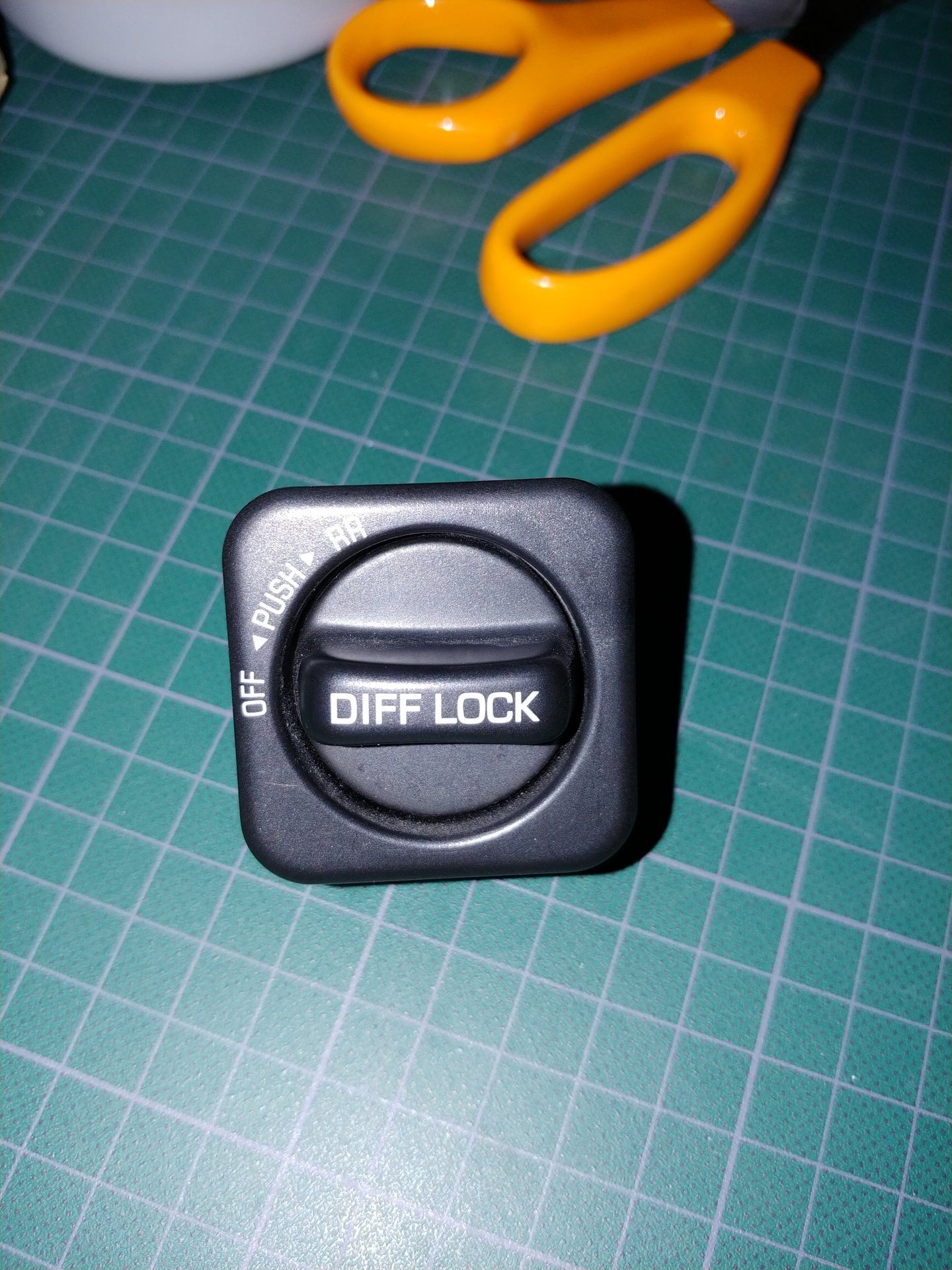

The same question for the diff lock switch: where is the bulb located, is there one?
The diff switch has no bulb
After examining it further, I started to suspect that there is no bulb, thank you for confirmation.

So far, the joystick, hazard lights and centre diff took the same bulb - 4mm diameter, which i suspect is called T4 when sold together with the plastic base.
Unfortunately, the rear fog light switch has a smaller size bulb, I suspect it is T3. Anyway, I had to take the bike to the automartket once again, just finished the rear fog switch as well.
The 4 mm bulb was too tall, too thick, 3 mm fits perfectly in the base.
