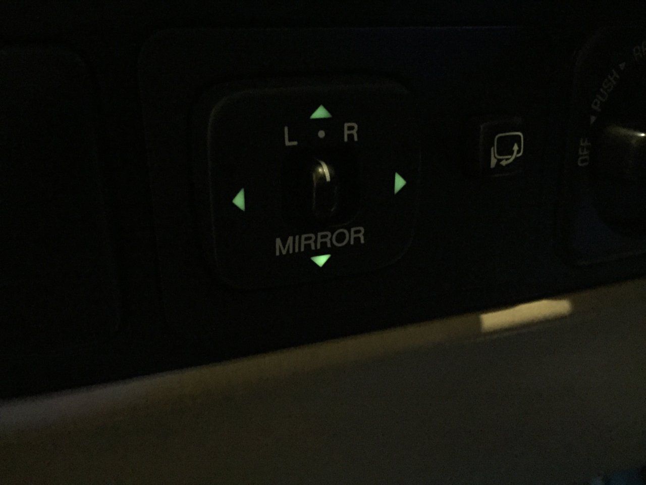

Can anyone confirm, should the mirror folding button (and its joystick) be let as well? they are not on mine, before I thought it is like that by design, but now I am suspicious...

can anyone please look at their mirror adjustment folding buttons - do they light up too?
Mine are not lit, so how do I remove that panel (please see the photo)?
Mine are not lit, so how do I remove that panel (please see the photo)?View attachment 2219487View attachment 2219488

I’ve checked the panel in your last picture yesterday evening, and for me only the “Rear” and “Power Heater” buttons are illuminated. This doesn’t mean a thing, because I might also have blown bulbs there - never looked at it serously yet.

The US LC switch cannot be easily modified to light up. However, I think if you have the retracting mirrors, the mirror control will likely light up (dead bulb).
Yes, the mirrors can be folded, there is a button to the right of mirror adjustments joystick.
