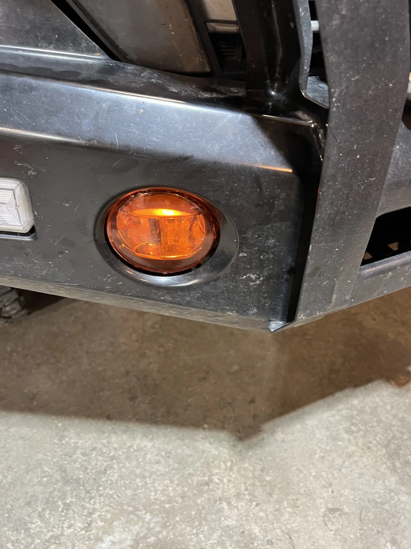

I did the cheap Laminex film, and it worked, but as a temporary solution. In retrospect, I should have bought the precut Tacoma version because I didn't get them perfect. I used a piece of clear flexible plastic and a sharpie to make a template, cut it out with scissors, installed using the dry method, and used a heat gun to help smooth it over the lens edges.
It really decreases usable light that comes off the factory lights.

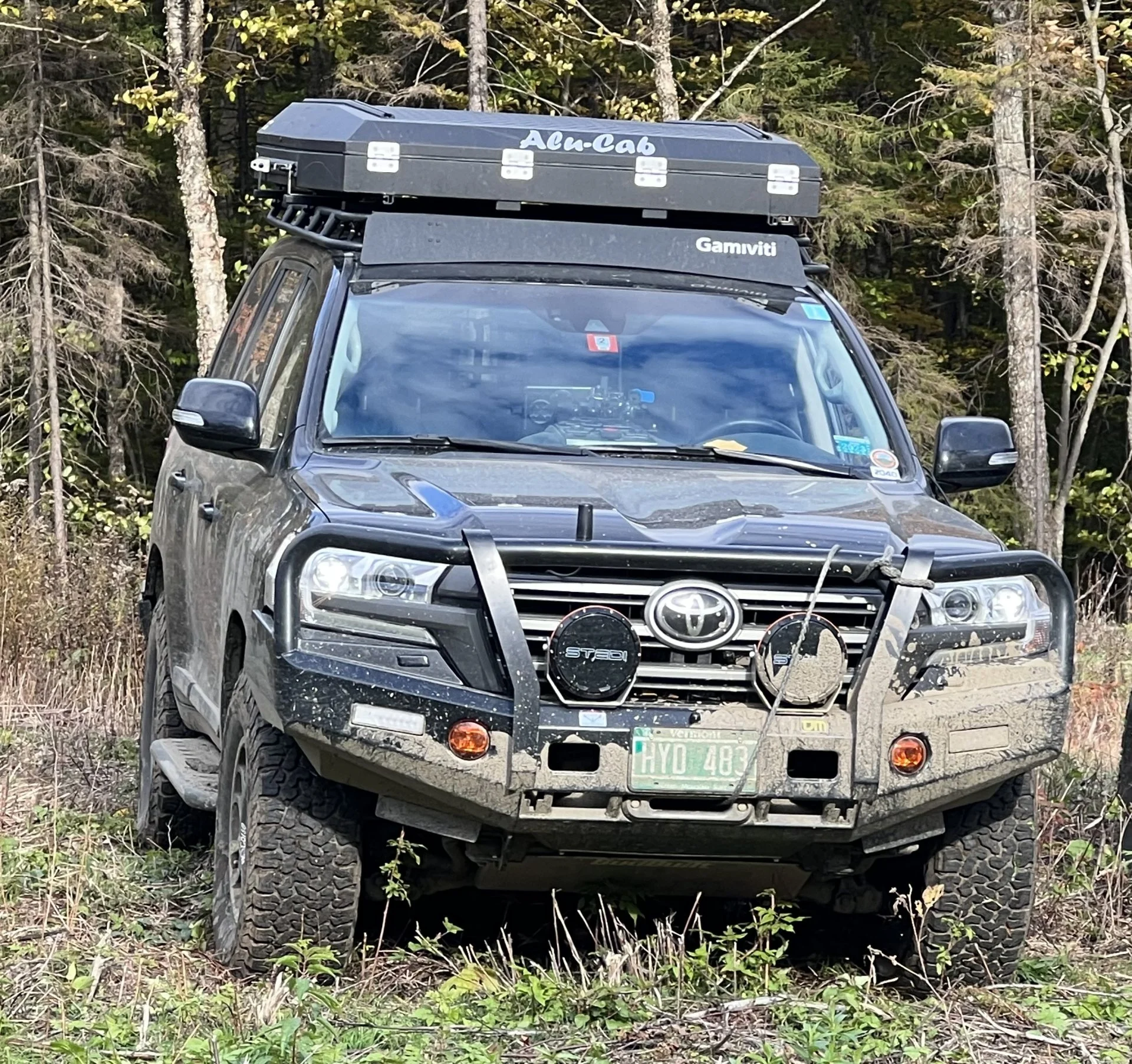

(and no comments about the janky wrapping of the winch line on the bull bar, thats what happens when a Land Rover guy stows the line - hahahaha)
