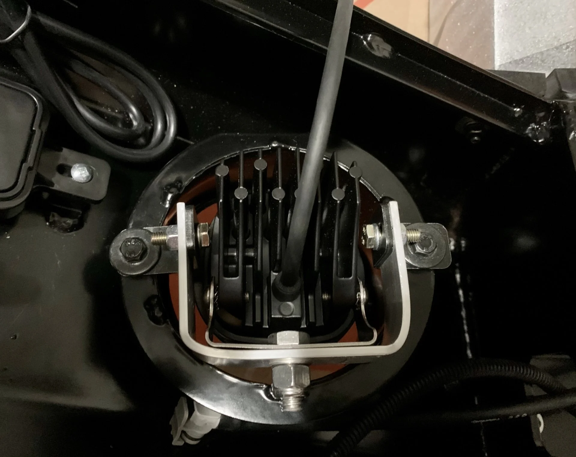

For a bull bar fitment it's definitely "Custom" but not hard. Here are some shots from @Tex68w 's old GX on how he did it. You just need a way to secure the light behind the bug light cup if you have a bumper.
Both BD and DD offer these kinds of brackets as well as some flush mount options that have plastic fascia that is oversized and you can cut to fit.

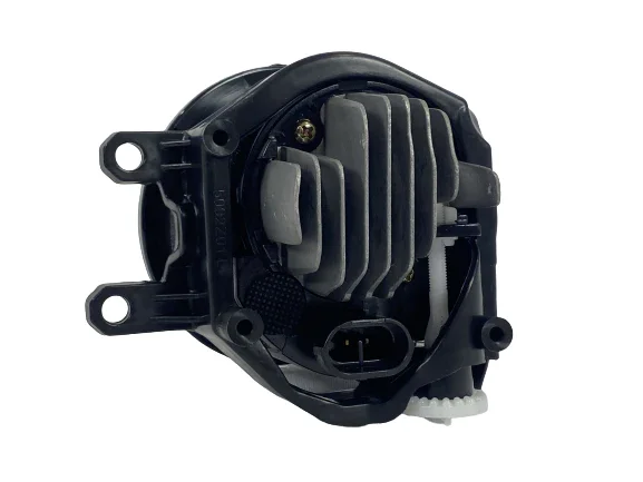

I hate to admit this, but I hadn't even considered that possibility. Thank you. I'll look into this option now! Somehow I thought when I had it out I observed that it was a sealed LED unit. It had a massive heat sink on the back side.
check out switchback LED lights on Amazon as well. Someone had mentioned that to me before, and I got to see them in person pretty neat. Turn them on they come on white, flick em off and on again and they came on amber/yellow
I don't think my bulbs are replaceable. Here is a pic from google, but is what mine look like:
