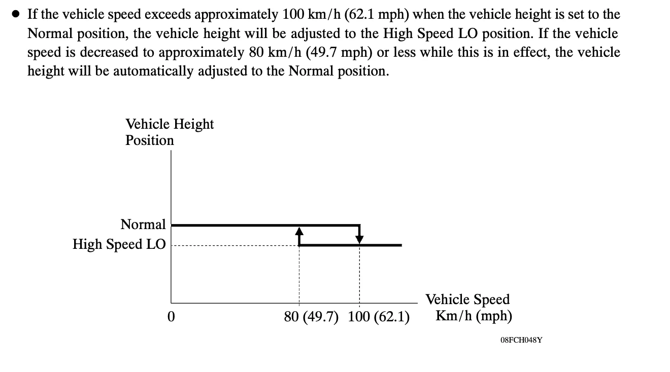

it drops 1" at 62 mph or thereabouts for better aero. I don't remember exactly what mph.

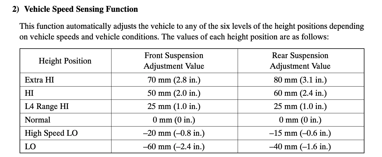

I wish that it was setup to adjust for rake as height increases. It is hard to understand why the front drops a full 2.4 inches in L but only goes 2 up in H.
It seems like it should be consistent across the range. If the front is already .5 lower, then why not keep the difference between front and rear static through the various modes?
