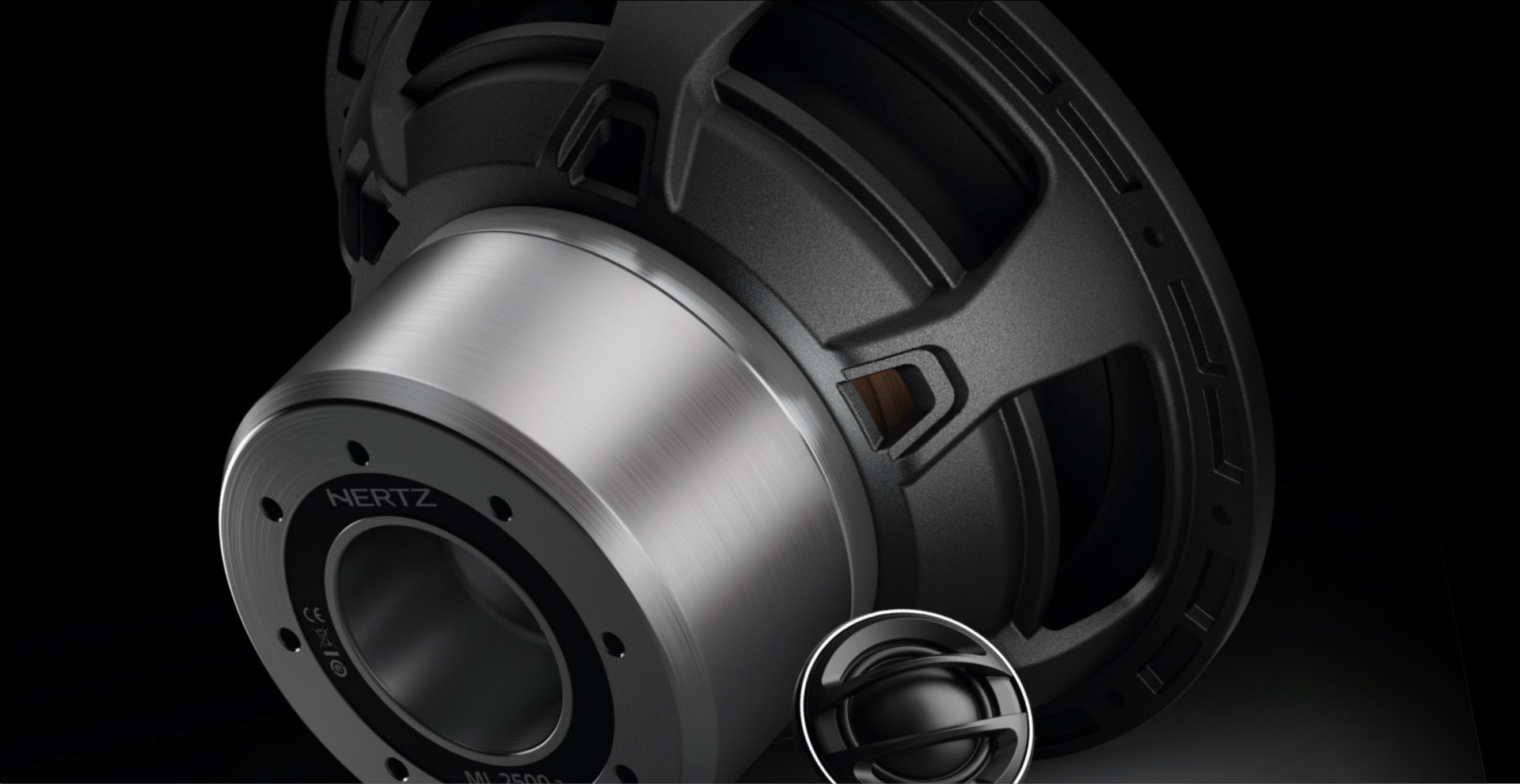

I mounted these in the front:
You have to enlarge the hole but no spacers are required if you mount them on top of the door panel. Hertz also sells a cover that has the old school mesh look and fits in this location too. Mine are still black because I don't mind how they look but if you painted them to match the interior most people would not notice they weren't stock. They sound excellent.
Hertz now has a few other offerings with a 2.0" overall height too, even a component system for those that want that.
