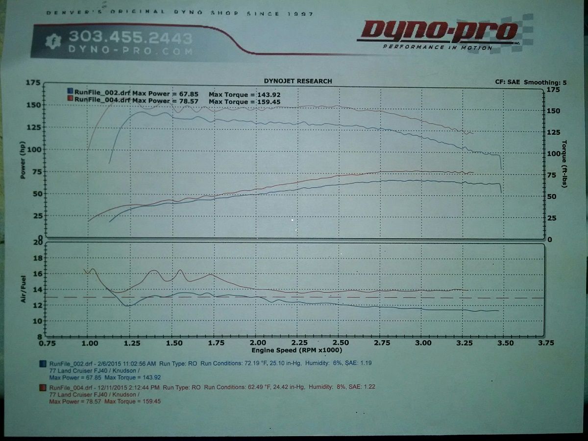

I dyno'd my 2F before, and after I rebuilt the engine. Not that I expected a huge jump in numbers, just curiosity. Picture shows the difference in the two. Done in Denver 5280' above sea level...

Got to love that flat-as-a-board torque curve!
