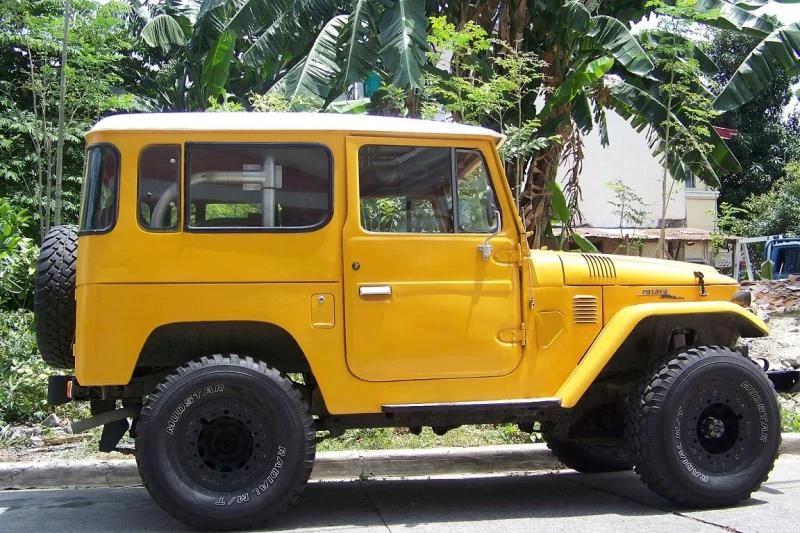

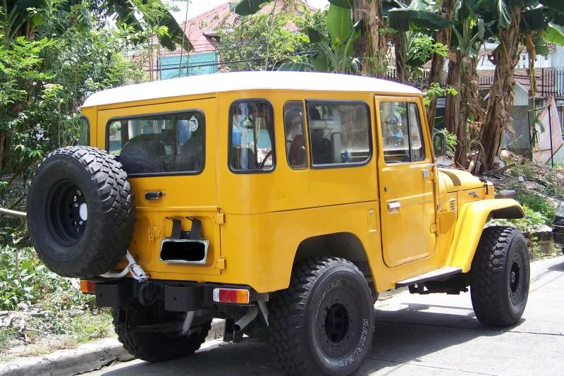

This is my truck, 74 tub and an 81 top. Had to convert to the hatch also which I like better anyway. You have to use the top header bar from a top with a hatch. Bikersmurf helped me a lot with mine as he also converted his. He does have a thread on here. Just check his post.
Looks like your rig once had factory jerry can mounts on the sides...
A lot of cruisers have had jerry can holder added to the body some where but never seen anything close to a factory installed jerry can holder in this country. This are almost alway just surplus GI holders.
