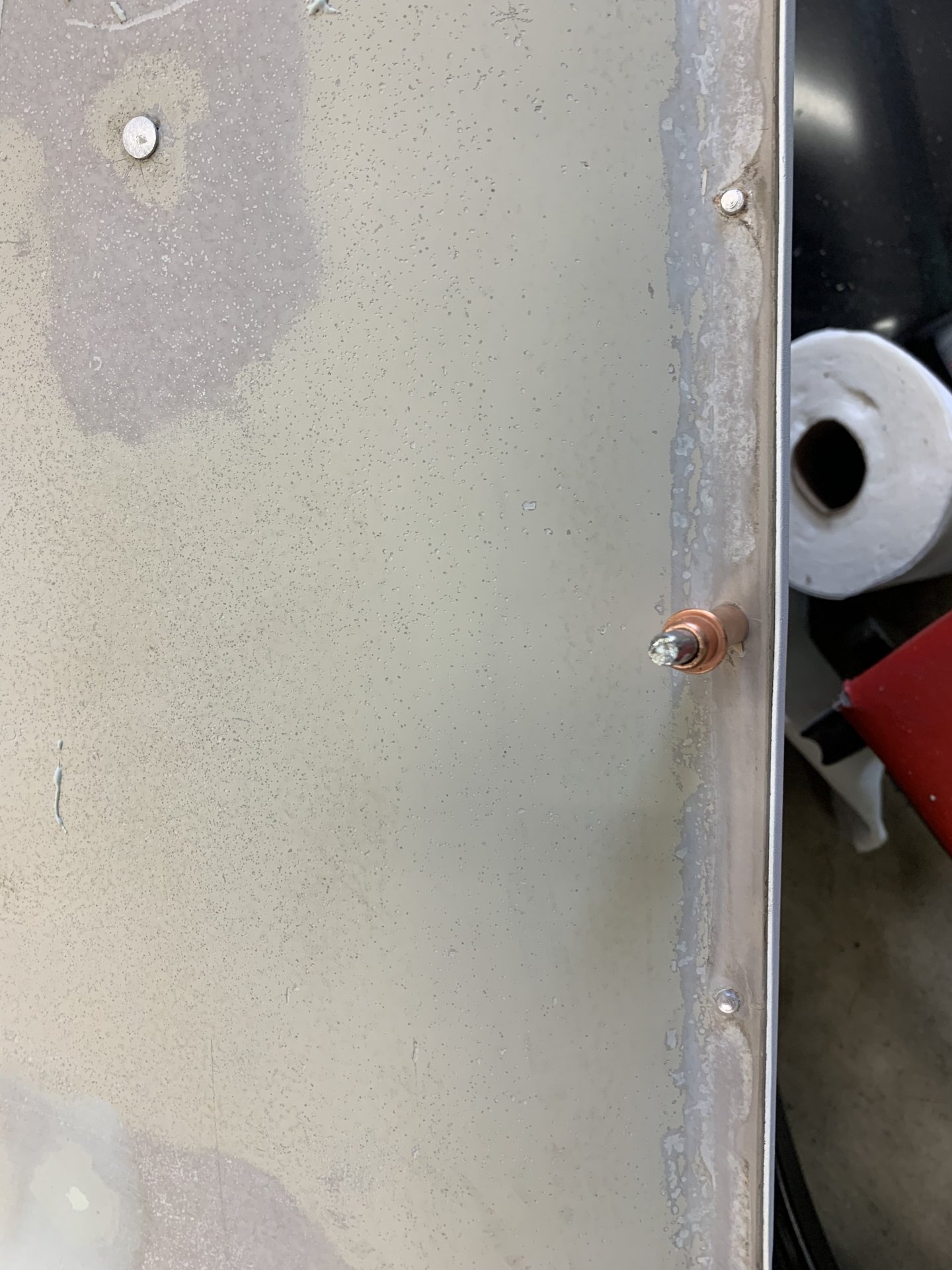

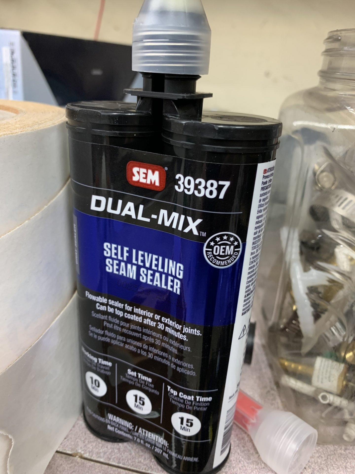

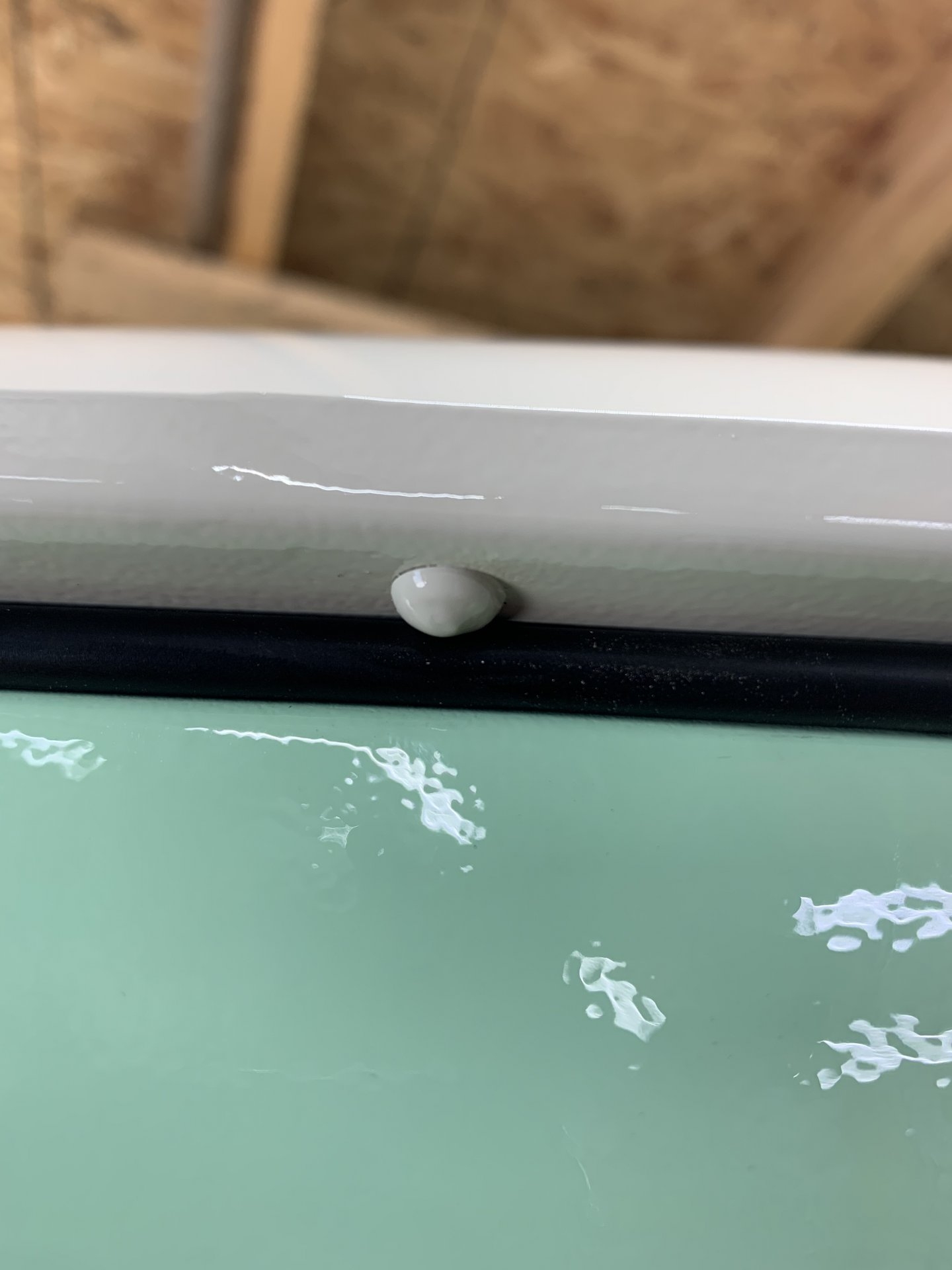

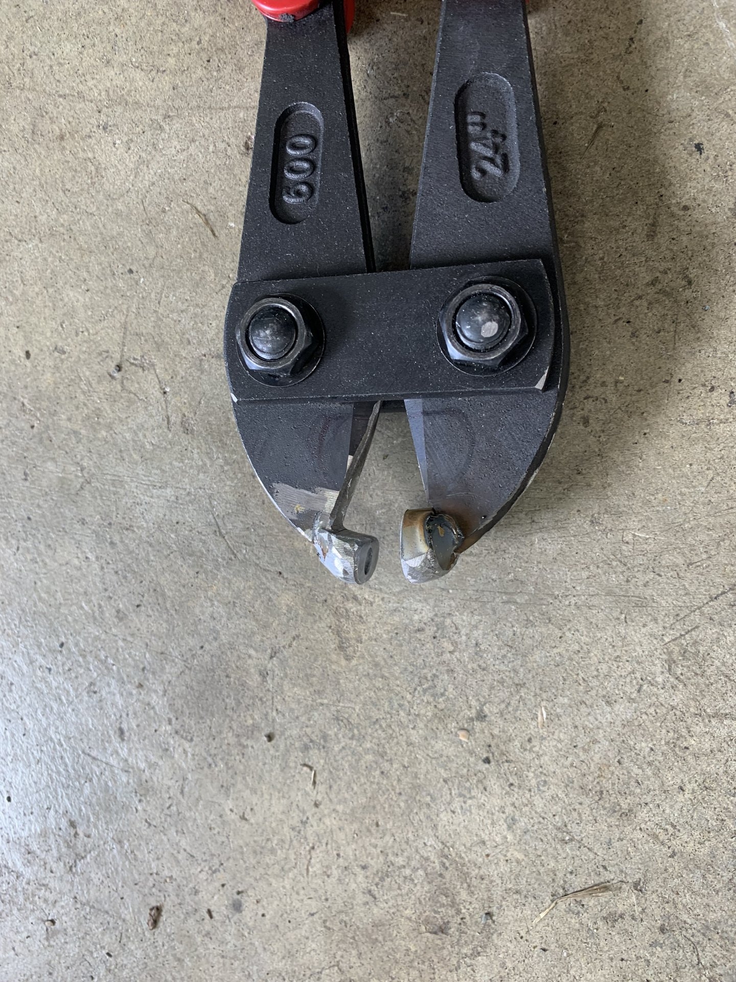

Assuming you mean install the gutter to the fiberglass; I used rivets and squeezed them together, then filled the gutter with seam sealer. Not all the way full, basically to the top of the rivets. I have extra rivets and the squeezer I made I’d be willing to loan out if interested. I see you’re in sw WA? I’m heading toward Long Beach later this month.
Assuming you mean install the gutter to the fiberglass; I used rivets and squeezed them together, then filled the gutter with seam sealer. Not all the way full, basically to the top of the rivets. I have extra rivets and the squeezer I made I’d be willing to loan out if interested. I see you’re in sw WA? I’m heading toward Long Beach later this month. View attachment 2750617View attachment 2750618View attachment 2750619View attachment 2750621

I primed the gutter rail first, riveted together, seam sealed, then primed all of it, then paint.

I did not seal between the gutter and fiberglass. A few reasons for me were: I figured sealant would goop out the river holes and get all over my clecos; I knew I wouldn’t be able to finish riveting the day I started and didn’t want the sealant to cure uncompressed.
it also didn’t seem like there was sealant from the factory.
