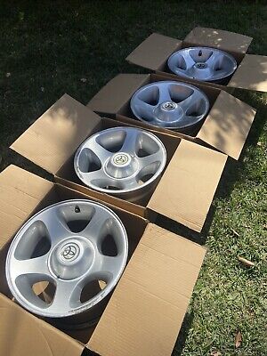

Hey gang! I searched around the forums and I couldn't find much, if anything, on these. Does anyone have a line on how to get some?
Here's what I know so far:
  • They generally come on the stock GXL model.
  • Earlier 100 series
  • Australia, mainly.
Any and all help is appreciated! Thanks! 🍻🍻🍻

I think those were Australian Market Only wheels and likely manufactured there, locally.
There are 3rd party companies that will handle shipping:
Yup! Those are them. I’m going to write the seller and see if I can snag a part number. Great find — thank you!! Because I am wayyy down the rabbit hole on this one.

However — you raise an interesting point, jLB. If that is the case, that might conclude my search. I’m not sure I want that much of a poke. Could be cool — just not sure. 🤔

Oh, and the wheels in your OP were an Australian 'dealer-fit' option. They are 16" dia.
Toyota AU specified them as Royale, manufactured by ROH. The Royale was available in zero offset for our 105s, and -60 for our 100s. It was later available aftermarket as the ROH Impact. Painted silver or machine finish.
*(thanks to LCOOL.org for this detail).
