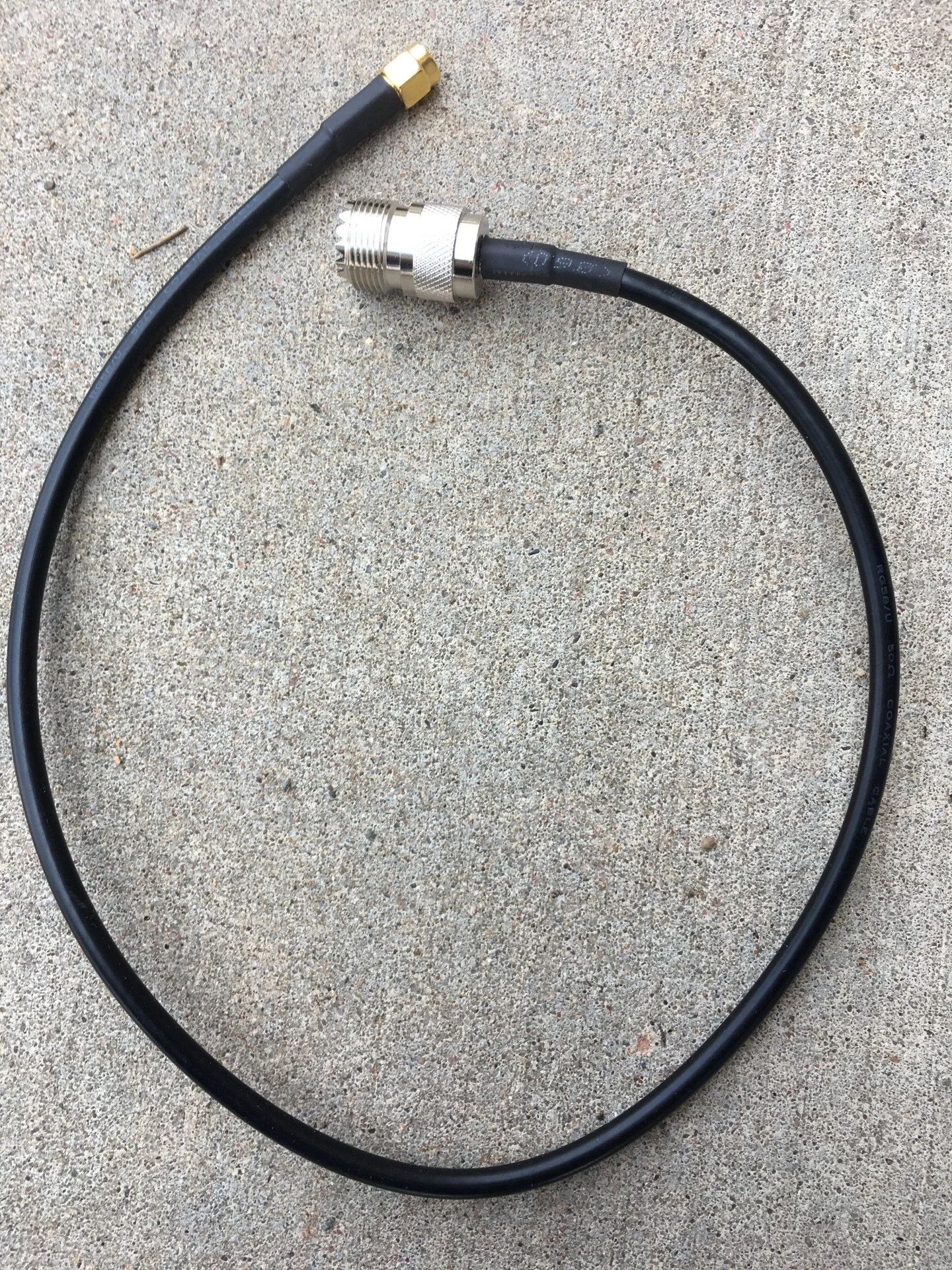

You will need one more small adapter with a PL-259 connector at one end and another smaller fitting for the handheld radio on the other end. The cable from the mag mount antenna will typically be a larger PL-259 fitting that would connect to a mobile radio mounted in the vehicle. The antenna connection for the handheld radio is much smaller and I am sorry, but I don’t know the name of that fitting. Someone should be able to chime in with that for you.
See the picture below - the PL-259 fitting is the silver one and the connection for the handheld is the brass one.

For RF connectors, citizen band (CB) most commonly uses UHF SO-239 (socket) and PL-259 (plug). Amateur radio (HAM) typically uses N-type, SMA, and BNC connectors for frequencies above 100 MHz. You may see some HAM setups that still use UHF connectors, but they're not ideal when compared to the others. For example, the UHF-N pigtail sent with my Nagoya HAM mag mount antenna. You'll find that many HAM antennas utilize the NMO (new motorola) connector for the antenna side. Most of the cabling used for these connectors are RG58.
