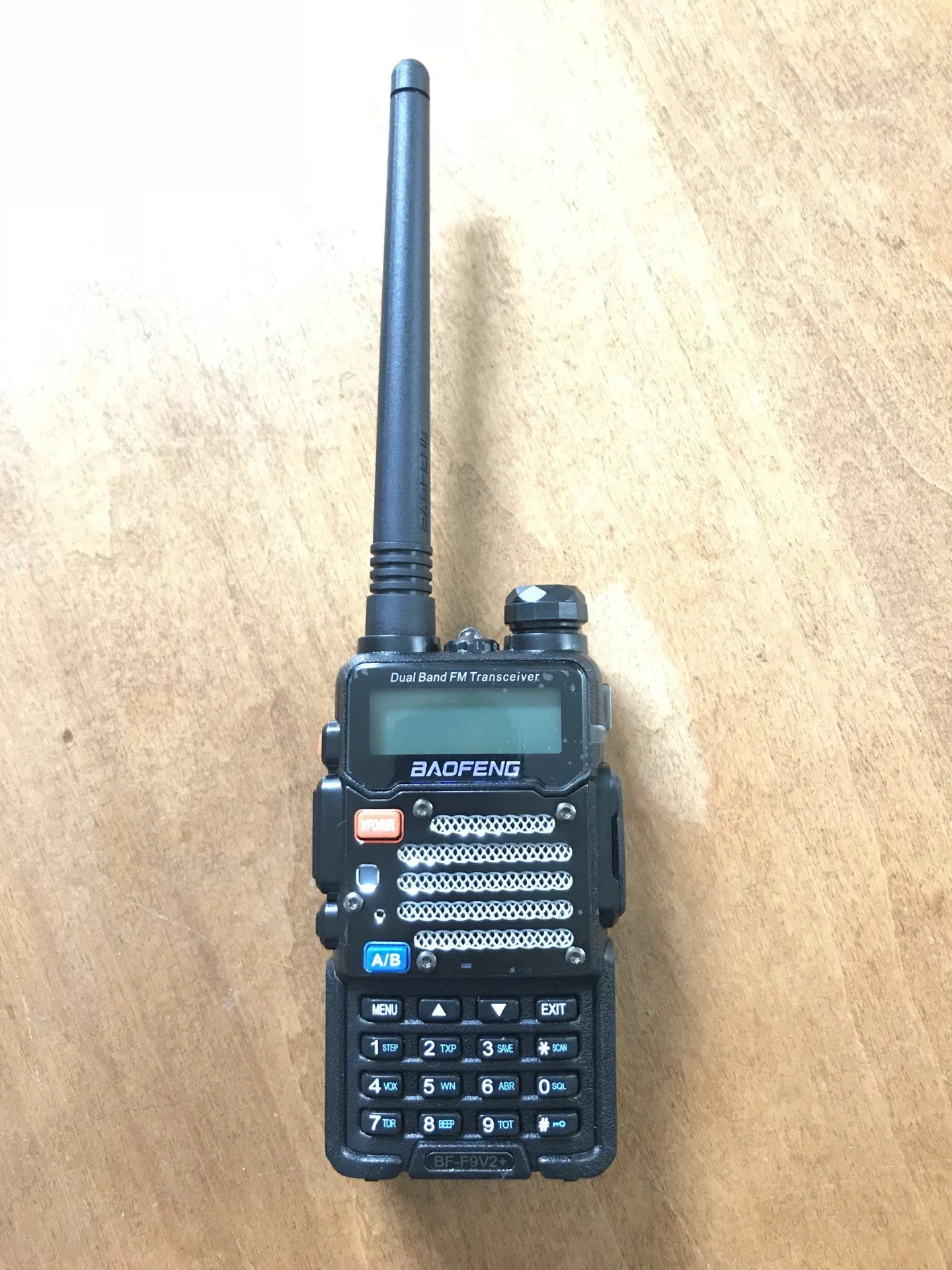

    This just arrived! First impressions are it seems well-made. I did a lot of research and bought from a legit vendor to avoid knock offs. I will be curious to see how it works. I’m guessing it’s going to need an antenna upgrade at a minimum.
