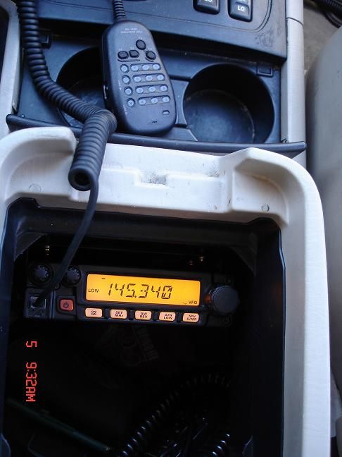

I put the Yaesu ft-1802 in my center console. The antenna was on a mag mount on the roof, has since moved to the front bumper. I know it's not very efficient but seems to work for now.

Ben, Looks good. Did you remove the cover or run with it open? Spressomon, I'll have to check the 208h out it may be just what I'm looking for. Thanks for the feedback.
