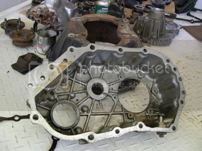

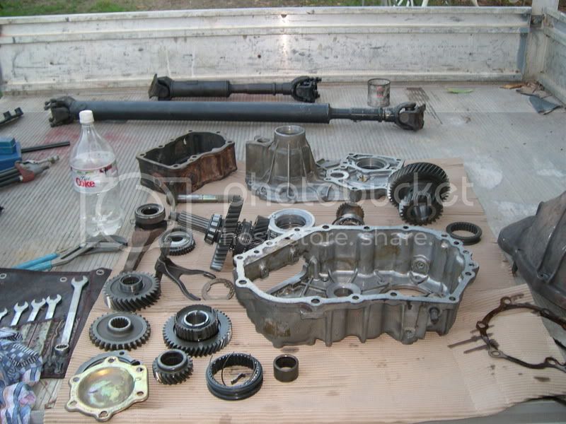

I bought a spare box a few months ago with the intention of replacing the bearings in it to fit to my car. Long story short, the box was opened up before I got it and it looked to have been hosed out and then siliconed back together, it was a righ mess inside, rust on most parts due to having no oil in it, so I abandoned that idea, lucky I did, I now know it is the fine spline one as above!
So I took it apart except for the input shaft bearing, it's stuck on solid.
Now, knowing how expensive the parts are for Toyota I would not want to take my box in to get rebuilt, I'd rather get something already opened up and done. But then begs the question of whether they would take mine as change over....

Lemme guess THe kids took it apart and you have to put it together again. :)
Cheers Mate, That was done by my son and myself and has been back together for sometime now [4 or 5 years] I think. I did a write up on it at the time. The manual got a flogging and I took a lot of pictures as I pulled it apart in case I forgot the sequence. Best regards.

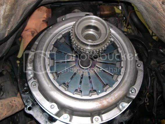

Does anyone know which way the clutch plate is supposed to go on these? From memory the prodruding part on the spline on the clutch plate goes towards the flywheel?

the side that protrudes more face the pressure plate.

I have it the other way and I have driven it and it seems fine. I was going by this pic below as I didn't get a response in time.....
EDIT: I have searched all my workshop manuals, the internet and the literature that came with the clutch and they all point to having the protruding part on the clutch plate towards the flywheel, as I have it. When I was refitting the new clutch I positioned it all together and the clutch plate would only sit in the flywheel recess one way. So fingers crossed, all is well.
Now I'm very confused. Am I going to kill it like this?
Cheers Brad
Hi .
98 % of clutch plates the high part of the plate faces the pressure plate . You will be sending torque the wrong way thru the plate also the dust slots wont expell the dust as well .
Hopefully the plate run is reverse will still have the same travel thru the springs too the stopper pins as normal and it will work ok.

So by the high part do you mean the center of the clutch plate where the springs/dampers are, one side sits out and the other is flush. I have it installed as you mentioned then. I'll take a pic of the old plate to help explain better. Below, using the old clutch is how I have it installed in the car.
I know if it were around the other way, I'm sure it would be very close to the flywheel bolts.

Brad , that is a 2H clutch and it is facing the same way as you have yours in the picture. The clutch and pressure plates are bdifferent. The 2H flywheel is different also.
Read again what Cambelt wrote.:cool:
:idea: Maybe email exceedy/daiken and get them to write front and back on them as nissan does on some of its clutches, cheers.:beer::beer:
I have it the right way, it will only fit one way, just stressing as I have spent $2500 on this bloody thing getting it working again!!
It drives well, just might need to bleed the clutch and let everything settle in, new clutch and reco box.

the 3rd pic shows the right way
