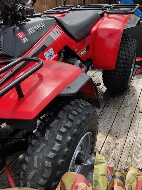

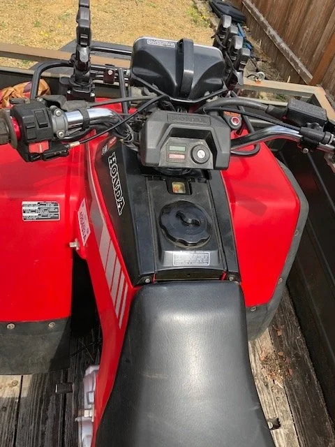

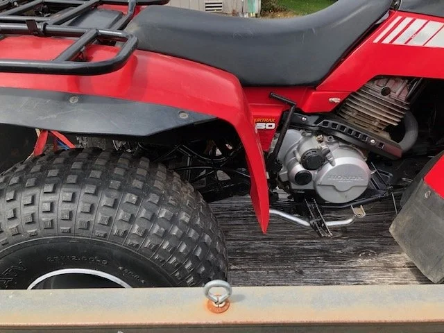

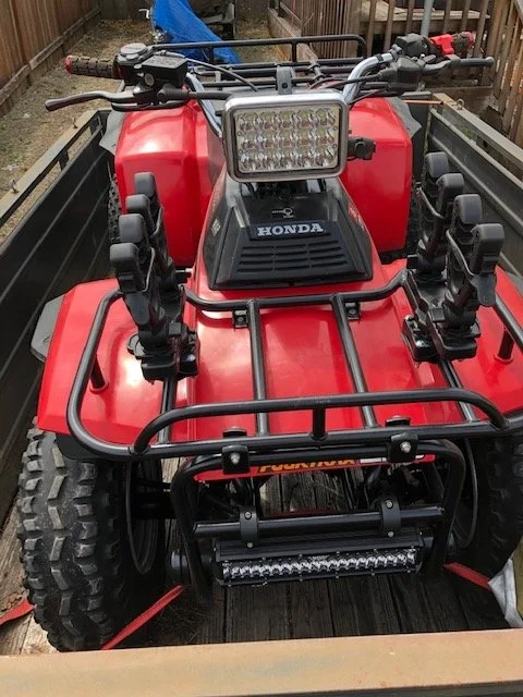

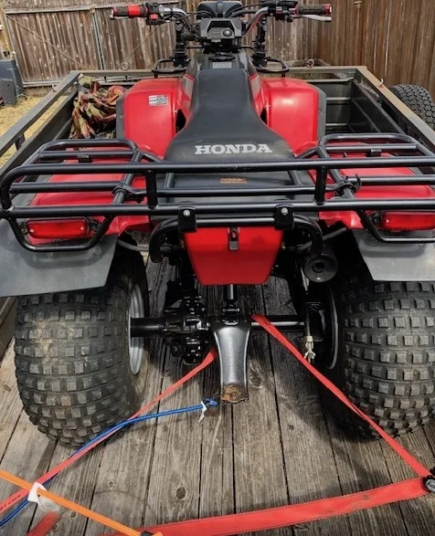

I saw a little bit of variation with KFB today.. it mostly stayed at -3.0 but getting on it up a hill with a trailer brought it down to around -2 a few times.
KCLV only dipped down to 25 a few times
Not a heavy tow.. just my old '85 Honda TRX 250

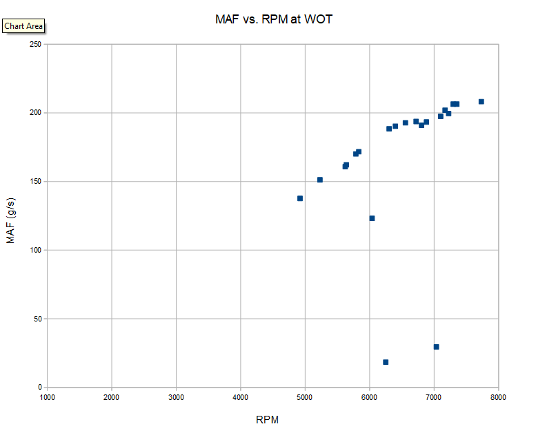

…and to the issue of power - check out post #72 at this link - example is from testing KCLV vs dyno results for the 2UR-GSE in the Lexus ISF.
If KCLV makes a difference in power, that would likely explain the improvement in power (and maybe mpg?) going from 87 to 91 octane.
Whether or not this power difference is big enough to be noticeable, is up for debate.
