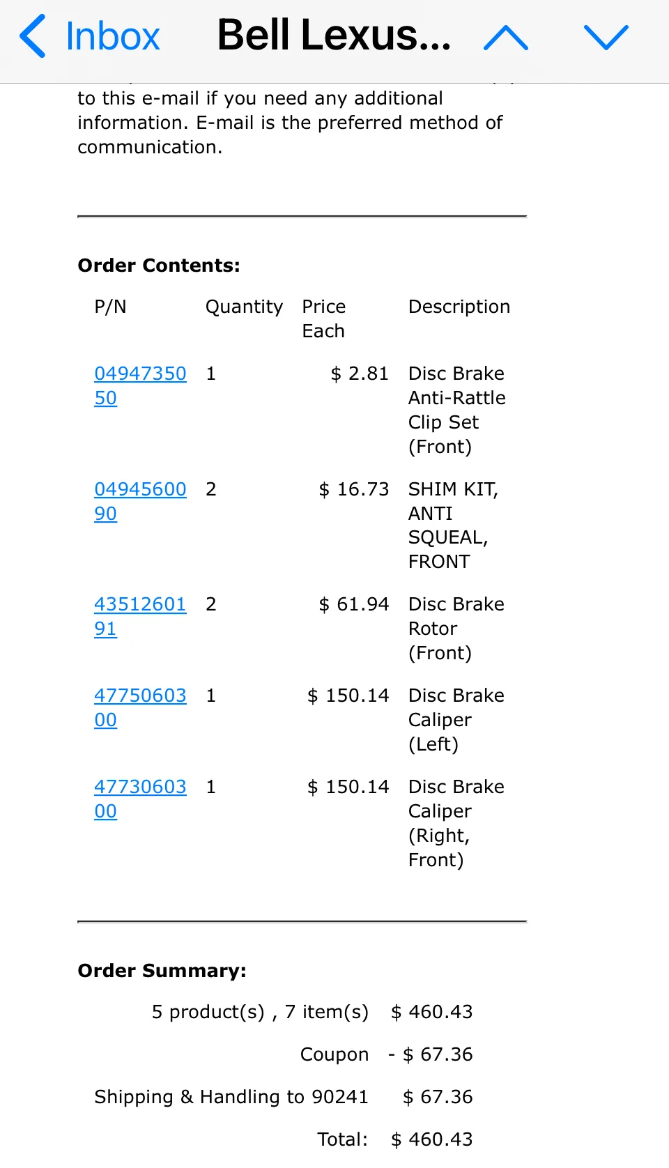

If your GX470 front calipers need to be replaced because they are old or they are stuck/seized, here are the parts to upgrade to the bigger GX460 calipers/rotors
GX460 Front Caliper/Rotor Upgrade
  • 47730-60300 GX460 Right Front caliper is larger to fit the thicker GX460 rotors
  • 47750-60300 GX460 Left Front caliper is larger to fit the thicker GX460 rotors
  • 04945-60090 (1) anti squeal shim set (invoice says two but Bell Lexus corrected and refunded one)
  • 04947-35050 (1) Anti-rattle springs for upper and lower (optional lower)
  • 43512-60191 (2) Gx460 front rotors (thicker by 1/4”) help dissipate heat better
  • Front ceramic brake pads Akebono ACT976 same as GX470. Or your favorite GX470 brake pads

There are two part numbers for the calipers they are side specific due to the brake line and bleeder location.
You are right…I looked at my invoice incorrectly. Fixed it and included my invoice
Are these direct bolt on? No modifications needed?
Yes. You're essentially changing the caliper and rotors up front to 460 stuff. I believe the front pads are even the same between 470/460 but I could be wrong.
I did this in 2021 about 50k miles ago and have never looked back either.
I don't think you actually want the small parts with the Akebono pads, they have the shims permanently affixed, and between the pads and the factory caliper set I just bought I had more than enough anti-rattle clips.
