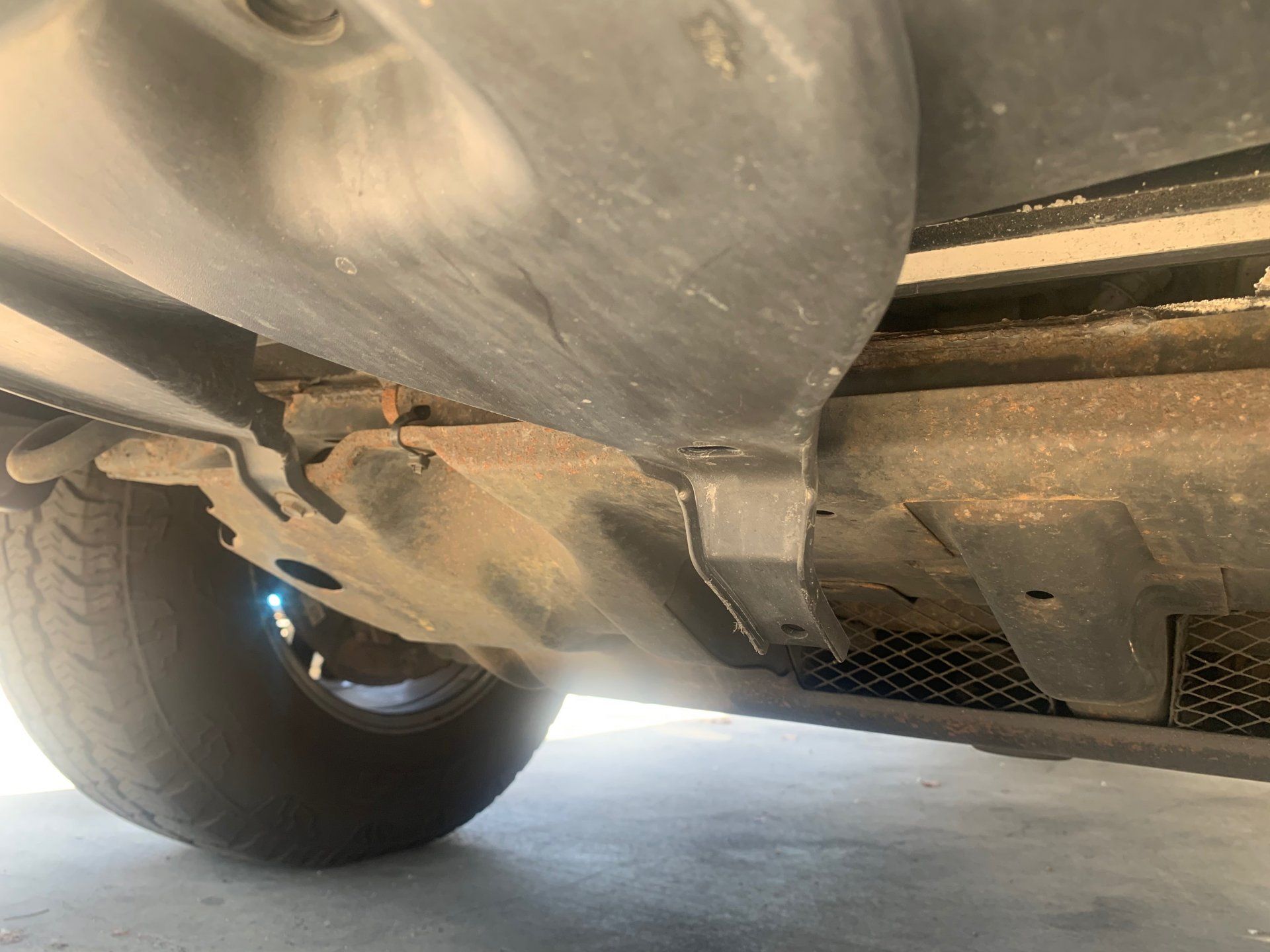

I came across a 2008 GX 470 super clean clean Carfax the original owners lived near the beach of Southern California. However when I looked underneath the front I saw some rust underneath the radiator going from the left wheel to the right. Should I walk away from the deal
That doesn't look bad to me at all. It looks like it is mild surface rust on the skid plate, which is removable. The radiator support looks like it has some rust spots but can likely be hit with a wire wheel and painted. How is the rest of the chassis?
Real good and real clean!!
Hey found you on here! Yeah thats not bad at all. That can be handled with some simple rust reformer. As long as the rest of the underside looks clean. I would say it's a contender.
